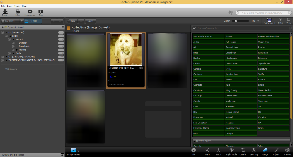

Btw, there is what I get after importing this file:
Again, your file was not last written with any of the IDimager products, so that leaves room to think that some other tool was used that could have messed your keywords up. Unfortunately, it's not possible for me to know what tool that was, but you may have an idea yourself.
