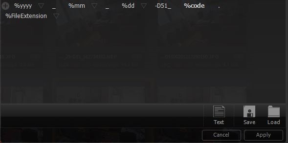

in order to make a batch rename of a large set of images, I'm building my custom batch command.
I saw that it is possible to embed a script into the file names rules
This is one of the great advantages of PSU over its competitors.
So I put my own script in %code, in order to extract the last 4 digits of the numeric part of the file name.
I tried a script like this:
result := RightStr(%FileNumber, 4);
but I got a number different than what I expected. Maybe %FileNumber returns a pointer which should be converted to a string ?
Can anybody help me ?
Thanks in advance
Maurizio
Re: rename script - Help!
You don't need a script for that; try this instead:
%FileNumber{right=4}.%FileExtension
If you want it in a script; I think this would give the same (but slower than macro only)
result := RightStr('%FileNumber', 4);
Post by maurizio »
Very helpful, thank you!
