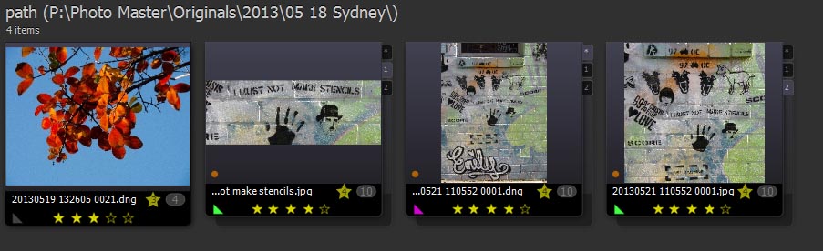

Example of Custom Thumbs info script: Coloured version indicator and a row of stars
(Note 2014-02-03 for PSu v2, there is no need for the vertical offset specified in this and some other scripts. Remove unwanted occurences of <ind y="2"> and </ind> from the code to fix the vertical position of the graphic elements.)
My way (I should say, this week's way, since I keep tweaking it) looks like this :
ThumbScript v5b Example.jpg (71.79 KiB) Viewed 294228 times
In this example, there is one Solo image and three Managed Versions of another image.
  • The grey triangle indicates the Solo image.
  • The purple triangle indicates a Main Version.
  • The green indicates any other Managed Version.
  • The stars show the rating.
All this info is already available in the thumbnail tile, but I find it hard to notice the Version Tab and hard to read the number in the yellow star.
Here's the script (with many thanks to Hert for the original on which it is based):
%code
var
  ACatItem: TCatalogItem;
  AVersionColor: String;
  AVersionShape: String;
  ARatingColor: String;
  ARatingStar: String;
  ARatingOnStar: String;
  ARatingOffStar: String;
  i: Integer;
begin
  result := '';
  ARatingColor := '#CFFFFF00'; //#### Yellow colour for rating stars
  ARatingStar := 'M 3.03,4.19883 L 2.996,4.22354 L 3.00909,4.26369 L 2.97501,4.2389 L 2.94086,4.26369 L 2.95394,4.22354 L 2.92,4.19883 L 2.96193,4.19883 L 2.97501,4.1589 L 2.98801,4.19883 L 3.03,4.19883 Z ';
  ARatingOnStar := '<img size="22" path="' + ARatingStar + '" pathfillcolor="' + ARatingColor + '" pathstrokestyle="solid" pathstrokecolor="' + ARatingColor + '">';
  ARatingOffStar := '<img size="22" path="' + ARatingStar + '" pathfillstyle="none" pathstrokestyle="solid" pathstrokecolor="' + ARatingColor + '">';
  AVersionShape := 'M 1,1 L 2,2 L 1,2 L 1,1 Z'; //#### Triangle shape for the version indicator
  ACatItem := TCatalogItem.Create(nil);
  if Catalog.FindImageCombined (ImageItem, ACatItem, False, vptNone) then
  begin
    AVersionColor := '#3FFFFFFF'; //#### Dark gray colour for Solo (unVersioned) files
    if ACatItem.IsVersion then
      AVersionColor := '#FF40FF40'; //#### Bright green colour for non-Main Versions
    if (ACatItem._MainVersionGUID = ACatItem.GUID) and (ACatItem.VersionCount > 0) then
      AVersionColor := '#CCFF00FF'; //#### Purple colour for Main Versions
    result := result + '<font color="'+ AVersionColor +'"><ind y="2">';
    result := result + '<img size="22" path="' + AVersionShape + '" pathfillcolor="' + AVersionColor + '">';
    result := result + '      '; //####This line adds extra space after the version symbol
    result := result + '</ind></font>';
    result := result + '<font color="'+ ARatingColor +'"><ind y="2">';
    for i := 1 to ACatItem.Rating do
      result := result + ARatingOnStar;
    for i := ACatItem.Rating + 1 to 5 do
      result := result + ARatingOffStar;
  end;
  ACatItem.Free;
end;
%/code
Here's how to use the script:
  • In the Collection viewer, at the top-right corner of the view, there's an icon labelled "View". Click on this, and an option dialog opens underneath it.
    The second title bar in the dialog is labelled "Custom Thumb Info". Underneath this there is a box where you can put in the script.
  • So, just copy the whole script in one step, and paste the whole thing into the box. You don't need to be able to read what's in the box. (If there's something already there you can remove it first, for example by clicking in the box, press ctrl-a to select all text in the box, and press Delete).
  • Once you put a script into one line, the thumbs will immediately update with the information (assuming it works). And an additional box for another script will appear below the one you just filled up, in case you want to add another line of info as well.
You can adjust the colours if you like. They are (I think) in ARGB format (eg '#FF40FF40'". The relevant points in the code are commented (look for "//####" in the code).
There are more versions of the script in this thread.
... David

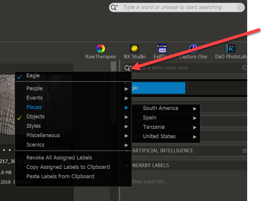

Re: Tips for working with Photo Supreme
Did you know that you can click the Drop Down icon in the Label Assignment Panel that allows you to pick a label from a drop down? That is convenient, especially when you don't know the exact name of the label that you're looking for...
