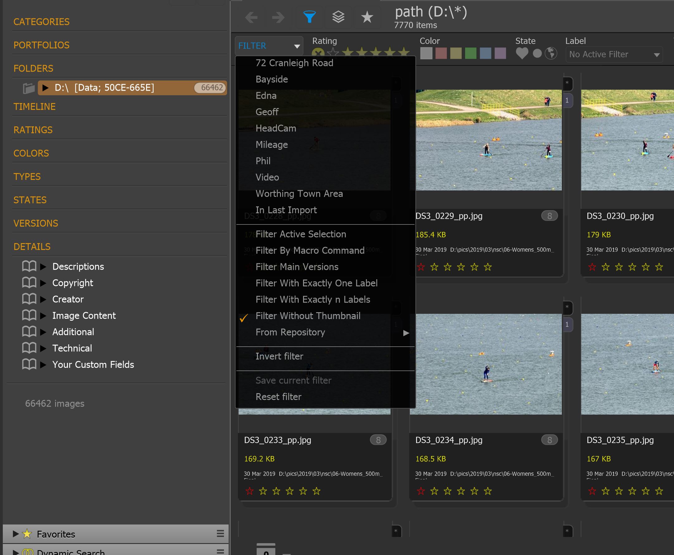

Must admit I've been finding this of late, using the Filters with "Filter without thumbnail" on the entire collection gives me this, I assume that perhaps its Thumbnails&Previews that might be missing but can't see anything that's actually wrong, even when opening the Preview window ?
Even tried Removing such files from the database, and then re-importing them, cures it initially but they then seem to return after a short while.
Oh and its happening on both this smaller database on the laptop as well as the much larger one on the main workstation.

I did now "Build missing thumbnails and rebuild" It found 249 and PSU rebuilt the thumbnails. After that I filtered for missing thumbnails like Geoff above. I get now 228 files listed but ALL with a nice thumbnail. Same result like you see in the screenshot from Geoff above.
Could other forum members run the same test? Would be interesting to see their outcome.

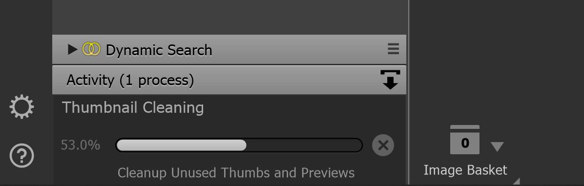

When you run the "Build missing thumbnails & previews" tool, it says;
Does this mean it is deleting from the thumbs.db Thumbnails & Previews that have not been used in some given time period,
OR
is it only referring to deleting of records where the thumbnails and/or previews have been left from previously deleted images ?

Post by Hert » 20 Mar 20 9:44
Well spotted!! That is it. The cleaning cleans too much :)

Post by G8DHE » 20 Mar 20 12:51
I would assume so -
"Build 2777; Fix for Thumb Cleaning, which is called simultaneous with Build Missing Thumbs and Previews"
about to test it now ....
