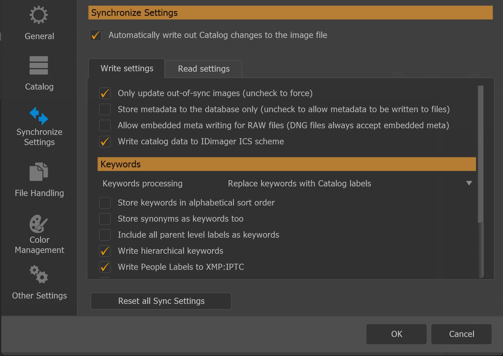

You may want to check the Keyword settings in the Sync options ?

Hert,
Thanks for the response, However this appears to me to be a different issue. Let me do some screen grabs and post them here and hopefully it will be more clear.
In this case PS is writing and PM is reading not the other way around.
I will get some screen grabs and I believe that will make sense. I resolved the issue that you spoke of earlier and was happily keywording and then stopped and now I'm done with another project and want to get back to it again.
