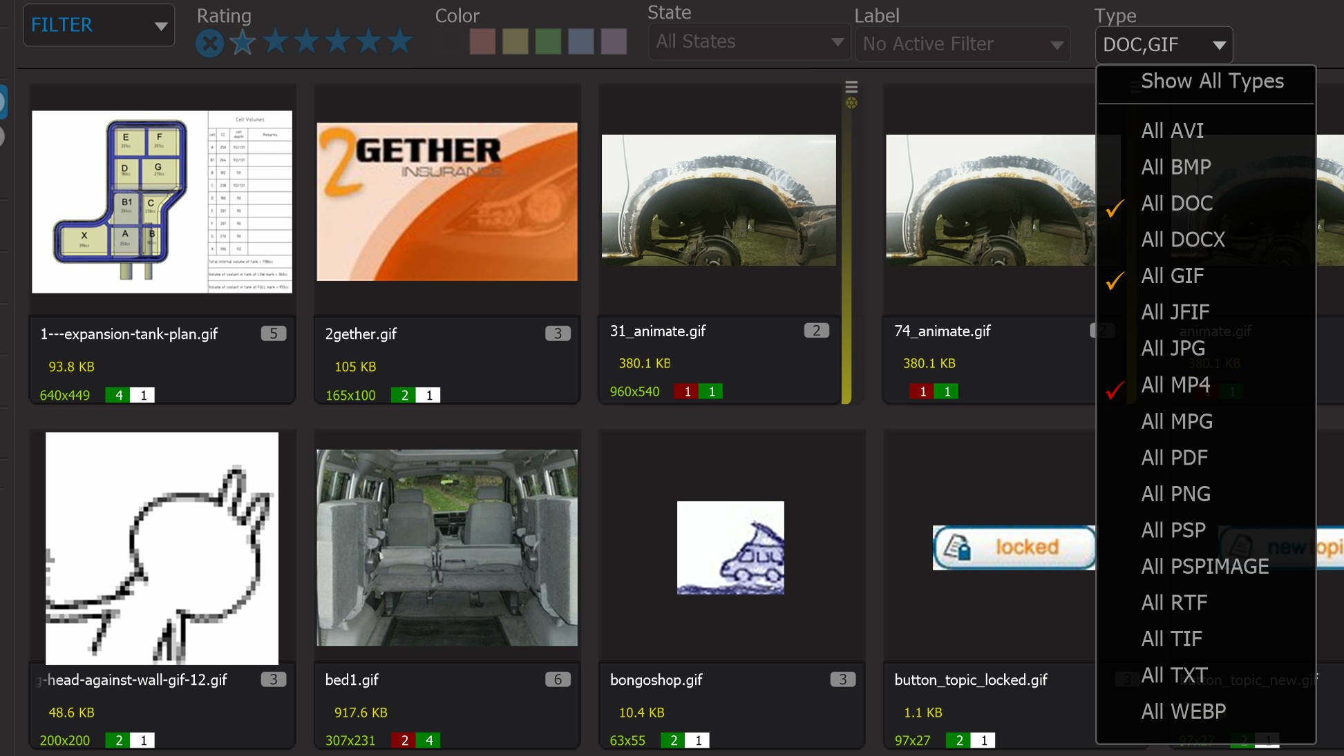

Whilst my database is mainly images there are also quite a few documents, PDF's etc I keep it all as a single database and then filter according to the file type if you haven't found it already click the "Funnel" Icon and then you can select which file types to display, as below click the file types to select as in OR (Orange ticks) and Alt Click to select NOT to exclude a particle file type (Red ticks);
Screenshot 2025-05-27 091745.jpg (266.54 KiB) Viewed 409 times
