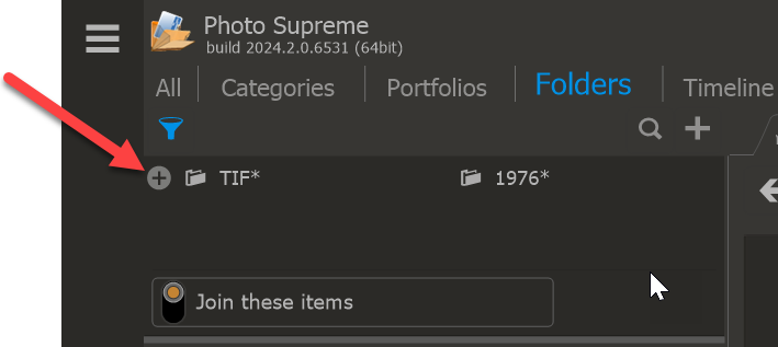

First of all, I am happy seeing that the Catalog Filter is being used. I think it is one of the most helpful features when you need to work on a subset of images.
You can always use the + icon in the Catalog Filter panel to add an element that is outside of the filter condition.
