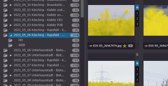

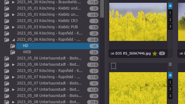

I use the versioning for different processing in the image size. My JPG main version is in a folder. The sub -versions are in a subfolder. RAW is in a parallel folder. So for each placeholder your own folder.
When I am in the folder category, I always see the main version in every folder. When I'm in a folder system, I would like to see exactly what the content is.
But when I'm in the portfolio I would like to see the main version.
It was good for me before V6. In the past, I was even able to define the placeholder for the main version. If I remember correctly.
Filter settings are a possibility. But then I would have to change the filter with every folder.
