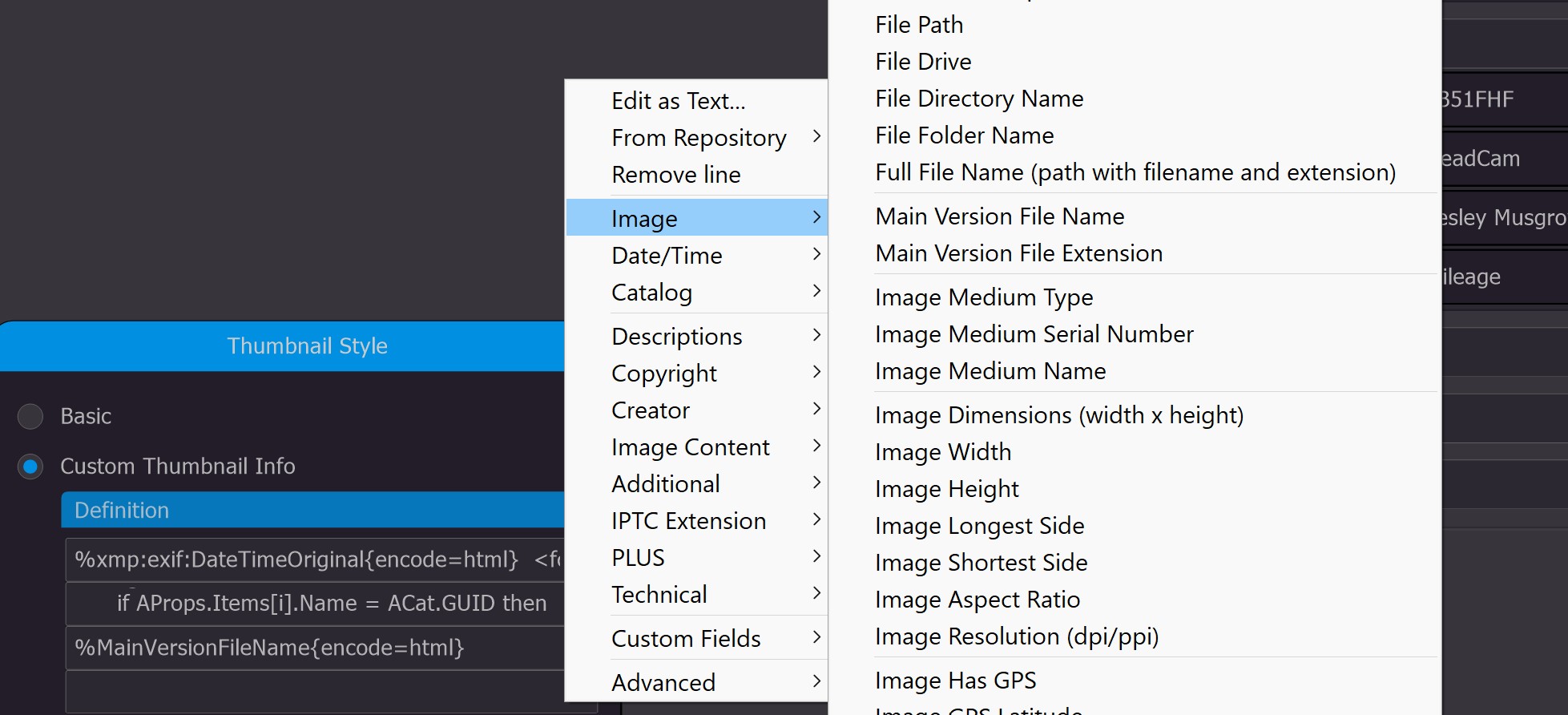

All the options seem to be there under Image ?
Screenshot 2023-11-22 104307.jpg (238.16 KiB) Viewed 20235 times

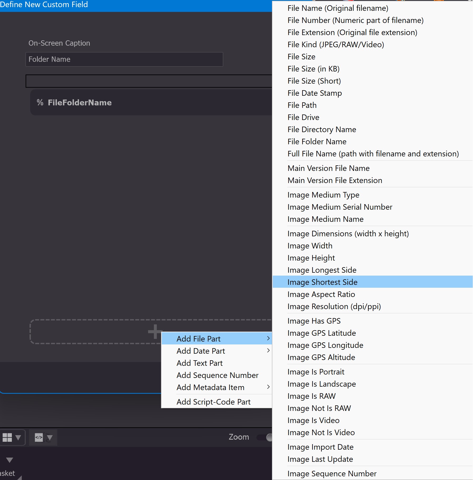

Try this:
  • At the bottom of the Info panel, select New Custom Field
  • Select Add Macro Field
  • Give the field an On-Screen Caption
  • Click in the existing %FileName macro field and use the Select Another Macro menu item
  • Select an appropriate macro (likely either Image | File Directory Name or Image | File Folder Name depending on what you want).
Re: File location display
The same options exist when defining a Custom Field in the Info Pane;
Screenshot 2023-11-23 150446.jpg (335.92 KiB) Viewed 20167 times
