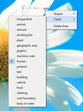

It's usually obvious from the image and my labeling whether the coordinates relate to the location shown or location created. But as a quick, effective, but dirty way of adding a separate 'location shown' tag, I misuse a face-tagging box by linking it to a location instead of a person. It doesn't comply with the recognized standard for LocationShown, but does mean I can tag multiple 'locations shown' in one image, which the standard doesn't accommodate, but which is frequently useful for aerial photographs and some landscapes.

Mke wrote: 22 Dec 20 2:34 ...as a quick, effective, but dirty way of adding a separate 'location shown' tag, I misuse a face-tagging box by linking it to a location instead of a person...
You can now do this properly in PSU v6, which now enables the region type to be something other than human, in accordance with the latest standard:
