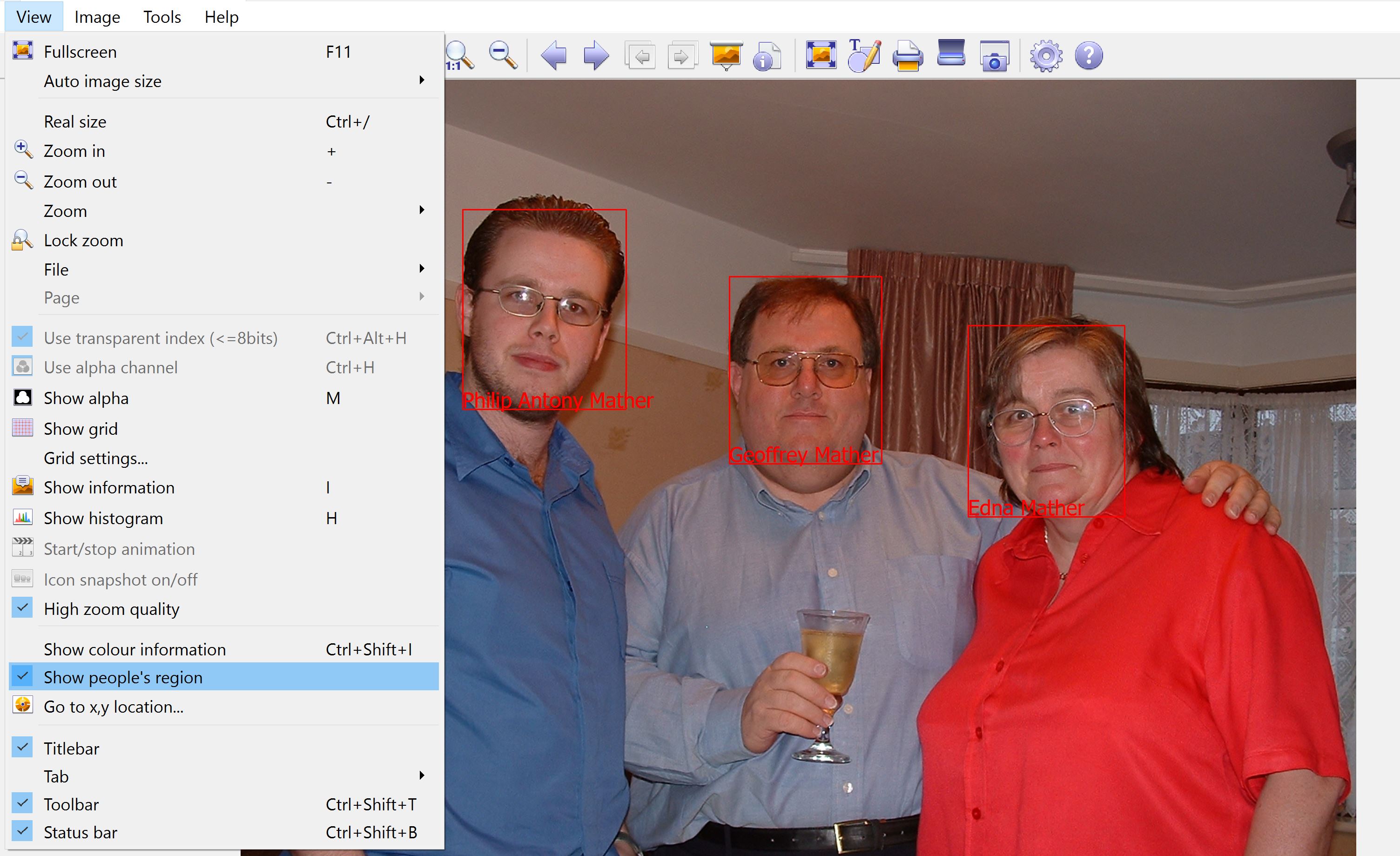

Posts: 754
Re: External Viewer for Face / Regions names etc.
Just an update the latest release of https://www.xnview.com/en/xnviewmp/does now allow viewing and display of regions. Its not the most convenient to use as only once the image is displayed does the "View" menu allow selection of the display option, but then it remains on till the window is closed;
