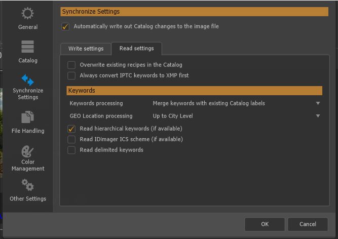

So now I wonder - are my settings wrong for metadata? How does "Convert metadata to XMP" interact with the database read/write options for metadata?
Metadata read settings.JPG (39.98 KiB) Viewed 4643 times
The attachment Metadata read settings.JPG is no longer available
Metadata write settings.JPG (47.4 KiB) Viewed 4643 times
