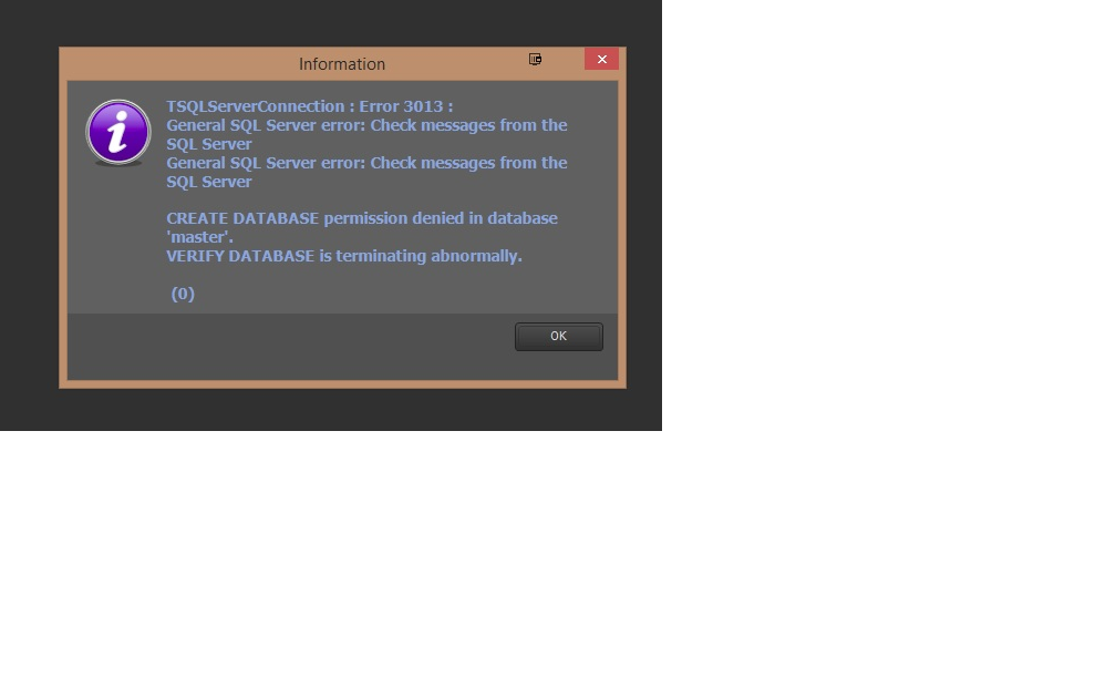

I am trying to backup my DB of PSU using SQL Server Express 2012. I have been able to do this many time, but now when I try this is the error that I am getting:
TSQLServerConnection Error 3013
General SQL Server error: Check messages from the SQL Server
Create Database permission denied in database 'master'
Verify Database is terminating abnormally
(0)
I am attaching a screen shot of the error as well.
I am using the default SA password of master2004.
I also noticed when I test the password before the verify part that it seems to take any value entered and says that it is ok. Is there a problem with the verify script?
Any thoughts on what is wrong are greatly appreciated.
Thank you.

- psu-error02.png (122.63 KiB) Viewed 2352 times

As stated in the SQLServer error it tells you to check the SQLServer log files.
A quick Google on the SQLServer 3013 error leads to this: https://support.microsoft.com/en-us/kb/290787
or this: http://www.sqlrecoverysoftware.net/blog ... -3013.html
From how I read it there may be an issue with the backup medium
Hope that help
Hope that help

Thank you for your thoughts. I changed from backing up to my NAS on the network to backing up locally and copying to the NAS and it seems to have worked without the error this time.
