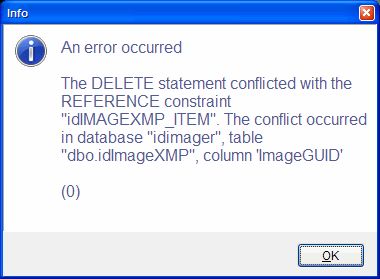

I couldn't relocate the main folder, it displays the error message box shown below. There were 12 sub-folders, and I was able to relocate 11 of them, with one giving the same nasty error. Unfortunately you can only relocate whole folders and not individual files otherwise I'd eventually (tediously) be able to determine which file was the culprit. The folder has 88 files I can't relocate.
- error msgbox
