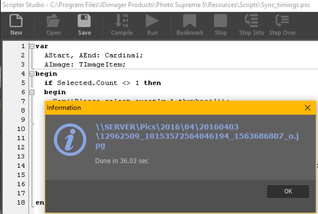

My images are all on a network share (Windows server) and I'm testing with a Wifi (AC) connected machine.
Performance for sync read won't be impacted by TTP. What can impact import performance significantly are CRS edits from Lightroom or ACR in your XMP. Especially when you use brushing in Lightroom, the CRS metadata can quickly become HUUUUUUGE. And PSU has to index that all.
Re: anyone having problems with Verify Folders for Files?

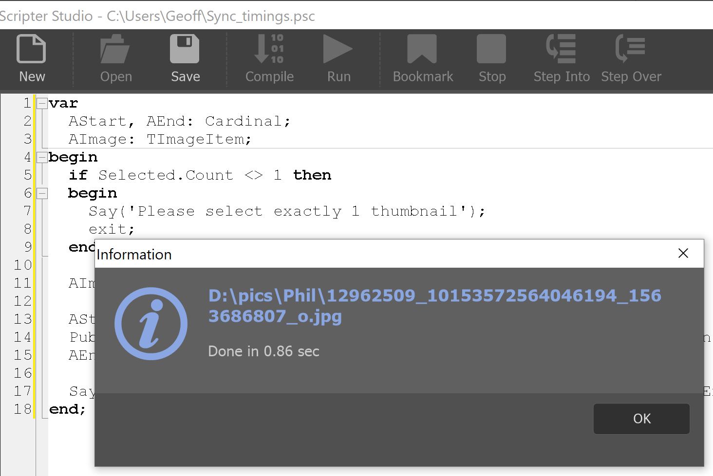

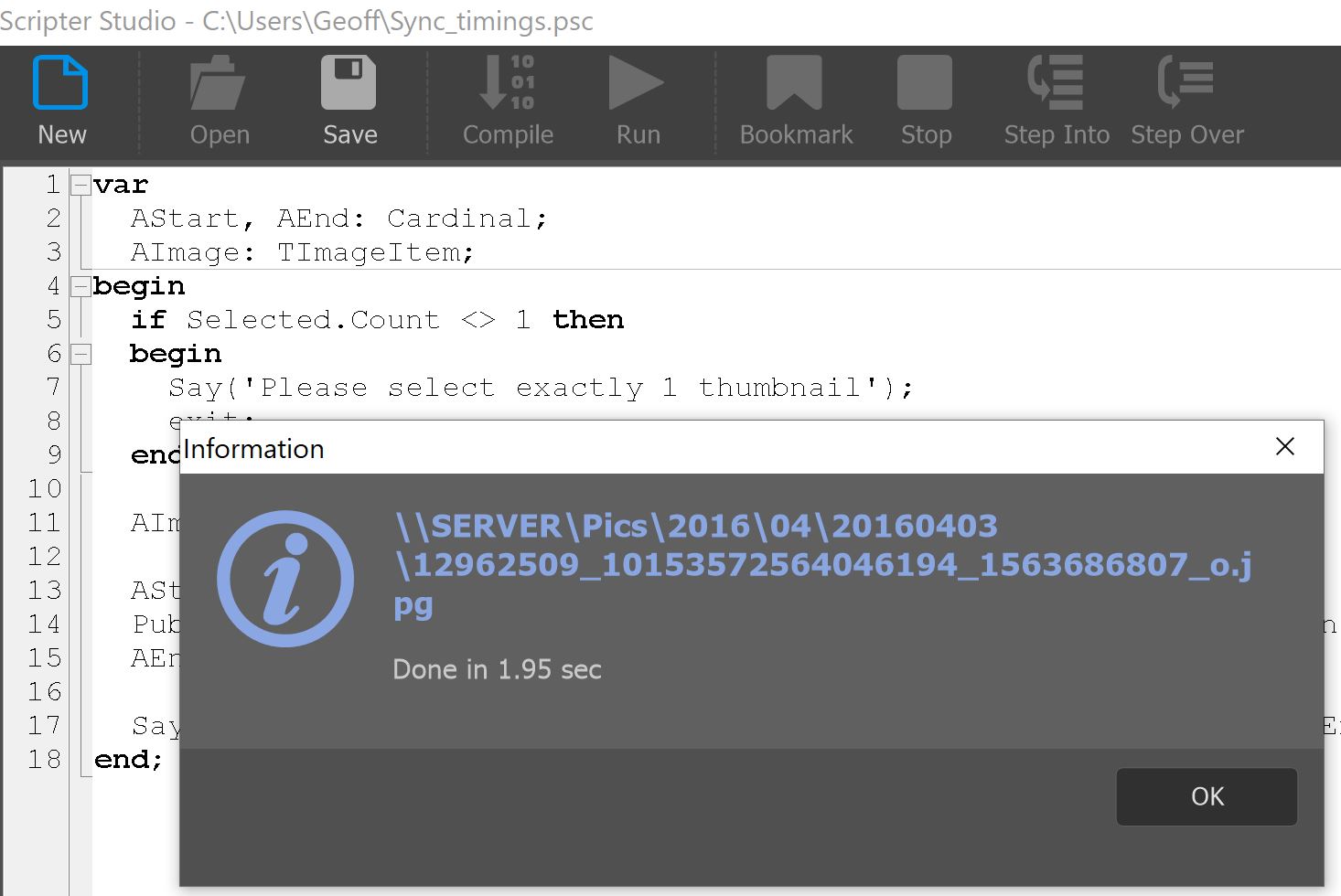

OK interesting result, the network is a LAN not WiFi;
LocalImage result;
RemoteImage result;
So a bit over double the time or half the speed, when the current sync has finished on my main workstation I'll repeat the test on the same image.

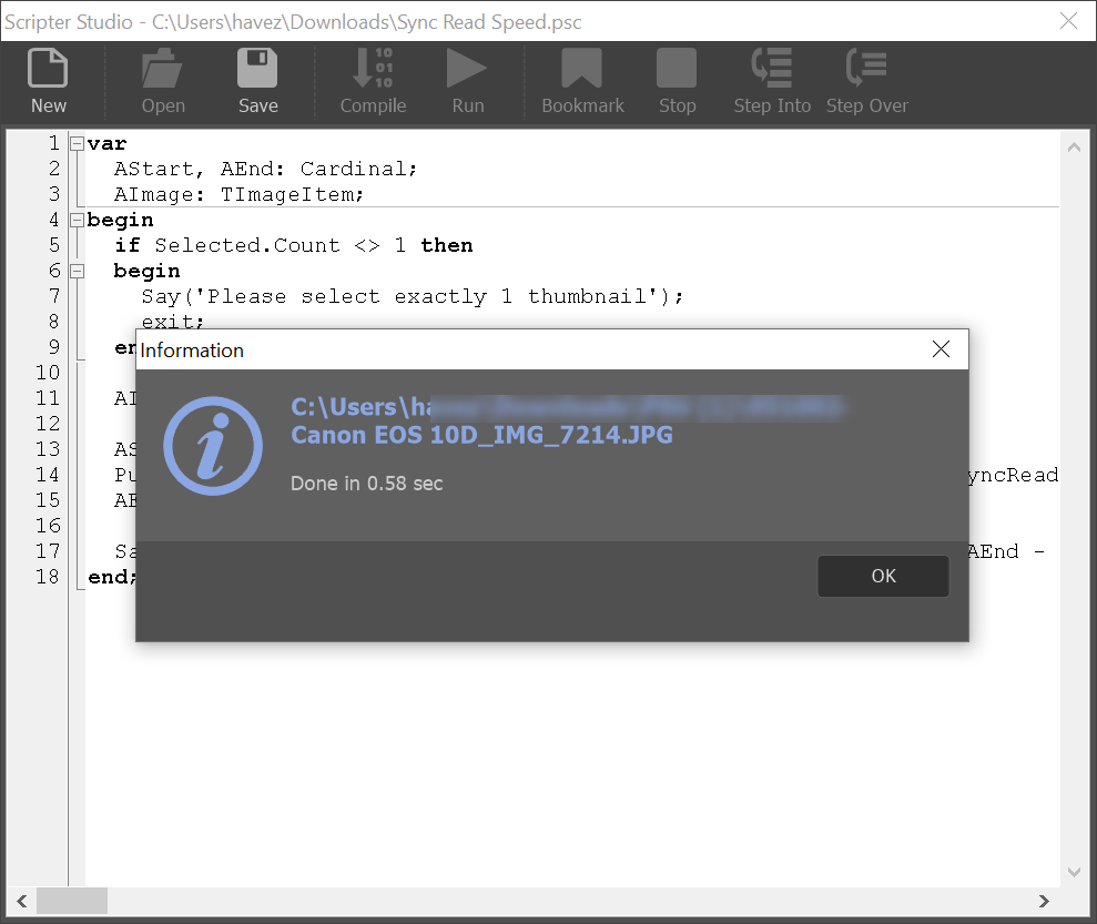

0.86 seconds is a good score. And since the difference with your network is large I think that means that your network has above average latency. is that a NAS or a Windows share?
As mentioned before, the image I imported was on a Windows network share and that took 0.61 seconds to import.
I now copied that image to my local SSD drive. With this result:
Sync Read Speed 2.png (49.81 KiB) Viewed 7222 times
Network vs local is almost the same. Actually I'm a bit surprised about that. Guess that means that my network hardly has any latency.

Right same script on the Work Station currently running the larger Sync job mentioned above 5072 files with the Activity pane closed;
I'll run it again later when the larger Sync job has finished as it will no doubt have had a serious impact on the run time.
Both the Laptop and Work Station are running W10 Pro, the file images are on a windows share to an old W2k3 server.

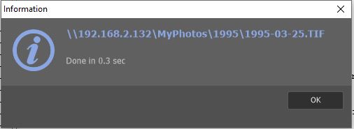

Ran the script and averaged 0.3 sec per image
done in dot3.JPG (17.5 KiB) Viewed 7141 times

@Geoff; can you re-run the script now that your import has completed? I'm curious how it scores on your workstation (was 36.03 sec), on your laptop+remote access (was 1.95 sec). I would expect that the workstation+remote should be able to achieve a similar score as the laptop+remote

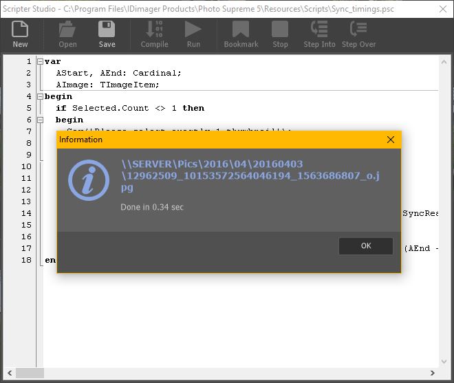

Right Hert yes with no other process running the result is
Which is what I would expect. Also now running 3361 in thumbnail view.
That’s a great result Geoff. Now can you sync-read test for a 100 images? If one image takes 0.34 seconds then 100 image should come around 35 seconds (+/- 10 secs).

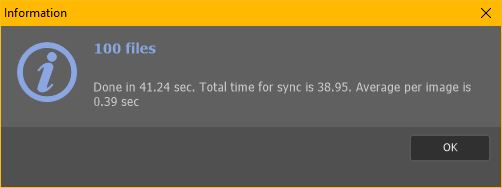

OK well Read Metadata for a batch 0f 100 similar sized JPG files yields 6:08 Minutes or 368 seconds so that is an average of 3.68 seconds each .....

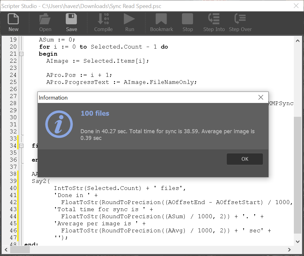

6 minutes to import 100 images...that's slow!
I've created a new script and attached it below. This script allows you to select multiple files and it calculates the time needed for syncing.
This time, again select 100 files and run the script.

This is the result on my machine.
Sync Read Speed 3.png (57.32 KiB) Viewed 6986 times
As you can see, sync'ing-read 100 files takes about 40 seconds to complete. Keep in mind that the application will be even faster because then screen updates are optimized, which a script can't do.

Right using the script on a 100 files gives times all in the 40-50 second range;
Doing a Manual read of the same files took 16-17 seconds on the one shown above.
There seems to be a lot of variability at times, despite the machine not having anything significant running on it, I'm accessing it remotely over VNC as I'm away from home at present.
