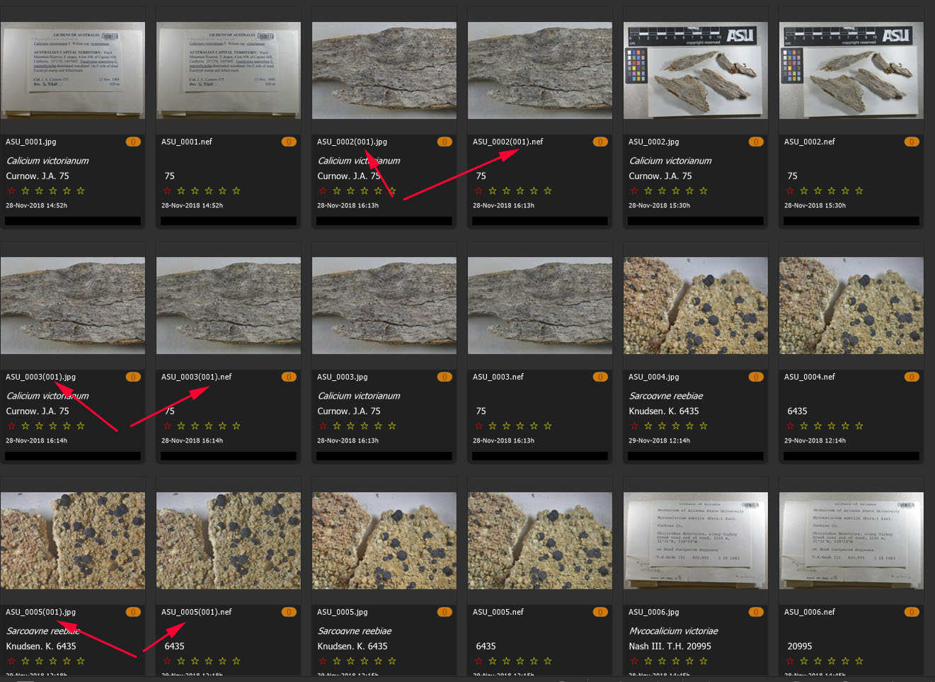

Next step: running it with "make file names unique"...
Now everything gets downloaded, but the names of files that previously were skipped get an additional (001) appended to their name. NOT what I want.
That the file renaming was messed up by the new multi-threading download feature makes sense.
It would make sense, that the resulting renaming mess, would also result in some of the files being considered duplicates and thus not downloaded at all...
But why would the program suddenly now consider some files duplicates, which it previously never did? Files that have a different name AND different time stamp???

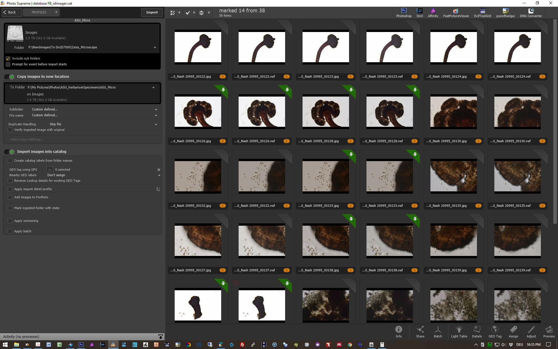

Out of 38 image files, only 24 are imported, 14 skipped.
No idea why.
Re: download/import skips images
Just to illustrate a screenshot.
After downloading and opening the importer there remain several pairs of images that are still marked for download, which the downloader simply ignored...
Not using the rename rule and only downloading JPGs, not pairs, no images are skipped.
