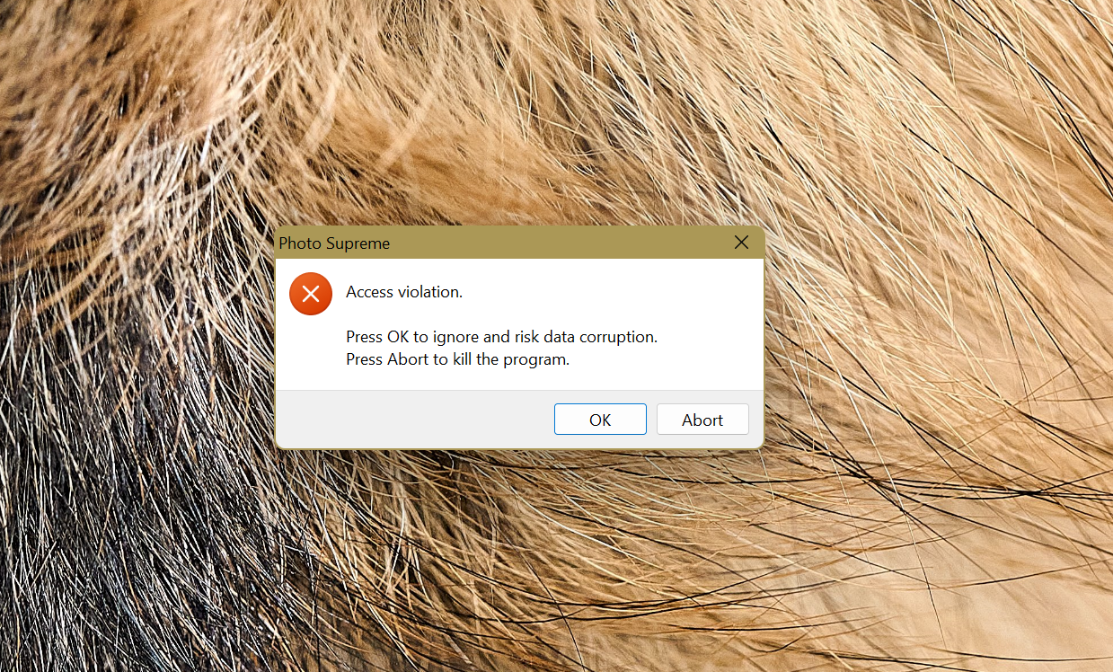

Not sure that it helps, but most of the time (not all) I am seeing the error in the attached PNG when starting PSU on the docking station.... (I don't see it when on the laptop.
dbug docking station Screenshot 2022-06-30 191304.png (1.94 MiB) Viewed 7431 times

Thanks for the Change High DPI settings apanella! Worked perfectly here.
Re: Photo Supreme 7.2 is available
apanella's input was very helpful. Please update to build 4402. For now, download this build from the Control Panel.
If you used it then don't forget to revert the custom Windows shortcut setting that apanella mentioned as a workaround in an earlier post.
