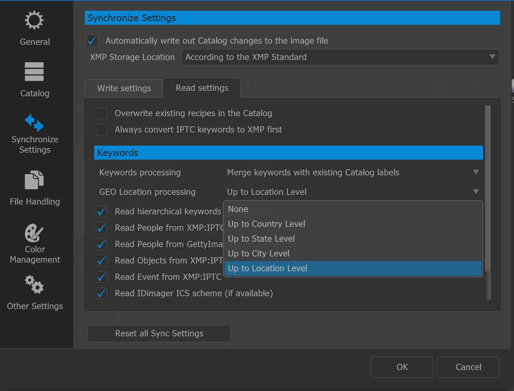

You can also control the level of the reading of location levels in the Settings dialog (reading)
PSULocation reading levels.jpg (152.86 KiB) Viewed 4503 times
and be aware that the Google information isn't as reliable as you might hope, doing Water Sports events if I'm in a Rib then the location information comes back as "Europe" even if I'm in the middle of the river Thames!!!
