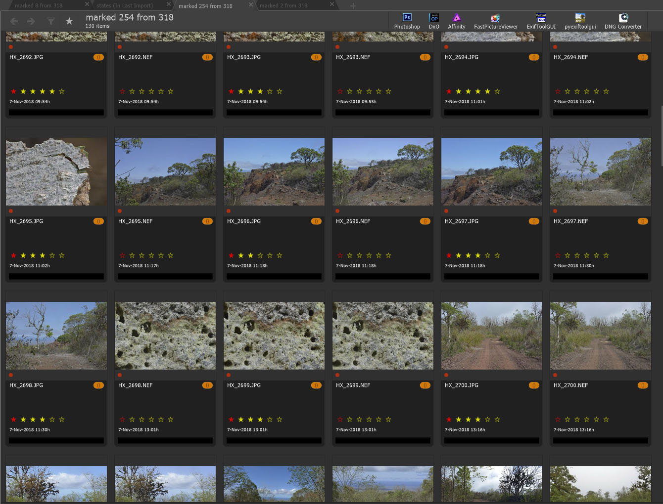

If I mark 318 out of a total of 318 images, only 130 images get downloaded. Oddly enough the images still get renamed according to the rename rule, despite having disabled that option and without any box popping up that showed a number with the counter :?
To me it looks like the renaming rule from the script is still being applied even though I disabled the option to run the scrip...

Here the screenshot that shows that not all files that were marked got downloaded and that despite disabling the script the images were nevertheless still renamed...

Result: the files are still being renamed and and not all files are downloaded...

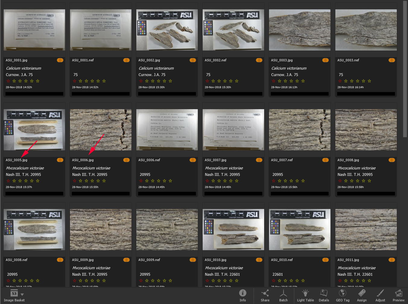

OK, I just added the renaming rule to the new profile.
Now, files are being renamed, but again not all files are downloaded, some are being skipped by the downloader and the re-nameing thus is a complete mess. These are just the same results as using any of my my other profiles.
The screenshot below illustrates this:
The NEF file that should have been downloaded and re-named ASU_0005.nef was skipped. This messed up the naming of the following files son that ASU_0006.jpg got paired with ASU_0007.nef and ASU_0006.nef with ASU_0007.jpg
Not only the re-naming gets messed up, also not all files are being downloaded. In this particular case only 39 files out of a total of 68 files were downloaded, i.e., almost half of all files were skipped...
