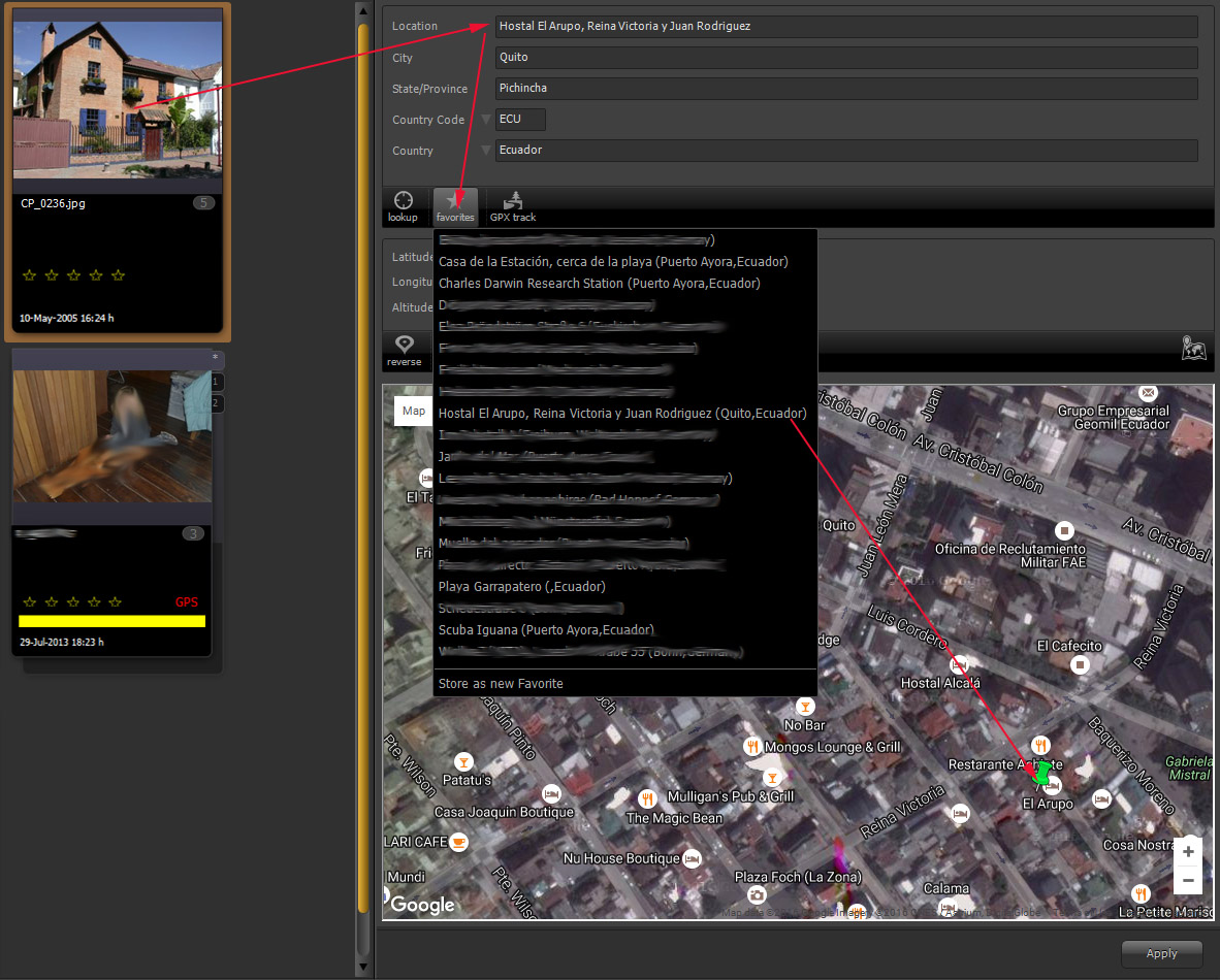

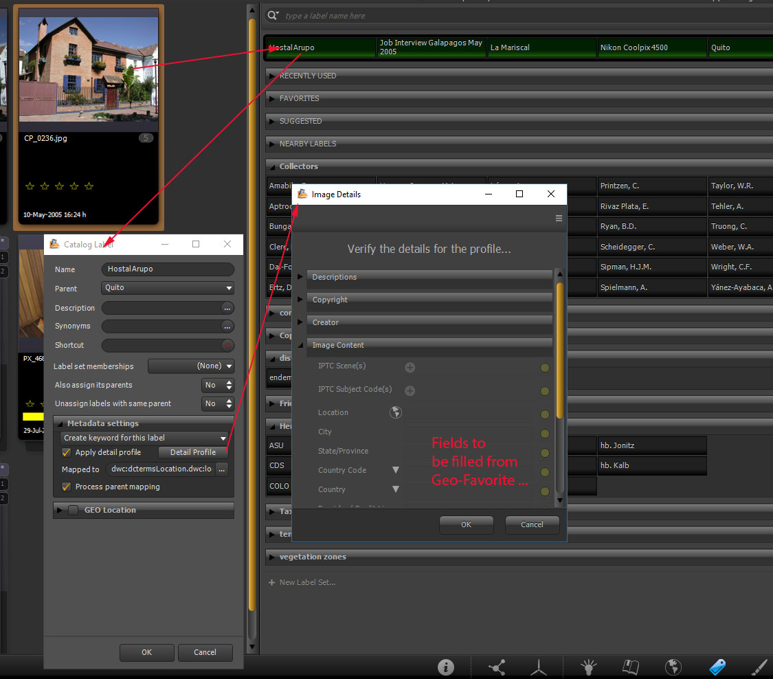

Reading through this lengthy discussion, I am surprised nobody asked this question:
Why not simply have an option to create labels from the Geo-Panel Favorites which from then on would then apply the Geo-Panel fields via "Apply Detail Profile" automatically?
To illustrate what I am talking about. This is photo of a favorite hostal in Quito with the Geo-Panel saved as a favorite:
Here is the same photo with its name as a label. That label can already be configured to write coordinates and fill in certain fields via "Apply Detail":
For me the obvious would be: in the Geo-Panel add an option to save the "Geo-Favorites" as a specifically configured label with the geo-coordinates and the relevant fields filled in.
This would be a powerful way to quickly geotag and at the same time not loose control of the process.

fbungarz wrote: For me the obvious would be: in the Geo-Panel add an option to save the "Geo-Favorites" as a specifically configured label with the geo-coordinates and the relevant fields filled in.
On the surface, your suggestion opens a bunch of questions and seems to add complexity:
- Where should Hostal Arupo be created as a label? what happens if Ecuador and/or Quito are not yet in your hierarchy - should they be created (and configured) automatically as well?
- Your 2nd screenshot suggests automatically filling the location metadata in the detail profile associated to the label, but I might prefer them filled in via the GEO Location section + the Mapped to... field; and then, there are additional alternatives regarding the label setup: should it toggle Process parent mapping or Also assign its parent? (Otherwise, the parent mappings for the city or country would not be automatically applied when Hostal Arupo is assigned.)
On reflection, I guess the label creation policy for GEO favorites could simply follow the current policy for Geo Location processing - and that policy, in turn, could be further tweaked by the user if FR #3020 (and/or #2844) is implemented.
If you geotag some image (by either entering the details manually or picking up a GEO favorite), then you could already convert that metadata to labels, based on your GEO Location processing setting. Am I missing something?

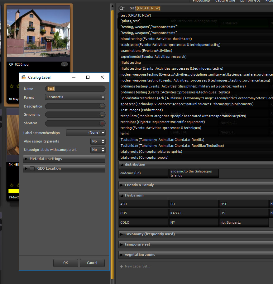

(3) the create new label dialog now pops up (like it would, when you create a new label in the label panel)
(4a) well, I guess the label could per default be created as a place below "city-country-places",
BUT as you say - this adds unnecessary complexity, so I for simplicity as well as flexibility I would actually prefer this:
(4a) alternatively the default parent would simply be your last choice when you did create your last new label; that is what happens right now, when you create any new label via the label panel. You then have to manually place that label where it belongs, say for example I create a label called "test", this is what pops-up:
Obviously "test" is not a lichen called "Lecanactis", it is simply the last parent I used, so now I manually need to change this parent...
(5) the new label would per default get the name of the "location"field (also with the option to simply change it, as I can still change any other label name in that dialog box). Per default the fields from the Geo-Panel and the coordinates would filled in: Location, City, State/Province, Country Code, Country + longitude, latitude & altitude
...should it toggle Process parent mapping or Also assign its parent? (Otherwise, the parent mappings for the city or country would not be automatically applied when Hostal Arupo is assigned.)
NO, no need to toggle anything! We are not talking about assigning parents, not talking about mapped labels but labels that apply a Detail Profile; i.e., one label that fills in all the fields from the Geo-Panel all at once! Have a looka again at the screenshot.
AND, even better: you already can tweak any label any way you want right now! Nobody prevents you from doing this tweaking manually for these labels too. Anything field that is being filled in from the Geo-Panel, you can still change, either during the time when the label is created or at any time later. I do that with my labels all the times...

fbungarz wrote: In my case I do have tons of images like this:
PLACES::Continents::South America:Ecuador::Pinchincha::Quito
I guess you could merge Places::Continents::South America with Places::South America.
But maybe you even shoudn't have to do this, but rather (have a way to) instruct PSU to look for the continent level under Places::Continents rather than Places. (Feel free to add a note to FR #3020.)
(ironically there was even a recent post asking about where to best place England after the Brexit: http://forum.idimager.com/viewtopic.php?f=57&t=24281)
To me, the issue is moot, as long as one doesn't use a European Union label. (Wisely, the default hierarchy does not ship with any such label.) I hope we can agree that UK (including England) remains in Europe, even if it leaves the EU.
For me, having the option to manually create and tweak these labels would greatly enhance the flexibility.
You already have the options to:
1) Manually create and tweak labels in your hierarchy
2) Manually edit and tweak geodata, including the details returned by Google or some other service
What's indeed missing is a way to tweak the algorithm which processes the geo metadata and turns it into labels.

Regarding label templates (#2844): that's indeed a complex feature to design (let alone implement), but additional settings for locations (#3020) could be delivered much faster, imho.
