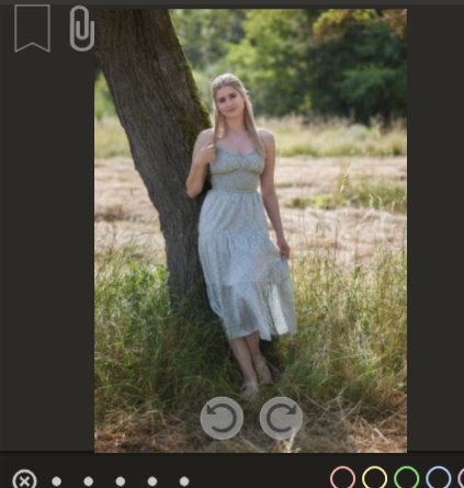

Yesterday I marked some pictures and (once again) accidentally clicked on the button to rotate the pictures: Of course, all the pictures rotated. :oops:
This button in the picture really bothers me because I never use it to rotate a finished picture. I am therefore asking for a way to deactivate this rotation of the pictures with a mouse click in the settings.
Many thanks in advance, Jens

Perhaps a simple confirmation request panel ? I've done this myself in the past especially when working on a laptop with a touch panel and undoing a large number of selected images isn't the fastest of operations :-(

I work a lot with touch and yesterday I accidentally rotated several images again. It's really annoying that you can so easily touch the fields for rotating the image by mistake and then the action is carried out immediately.

6597; Using the on-thumb rotation icons now prompt to start the rotation
[EDIT]
Option ca be disabled
