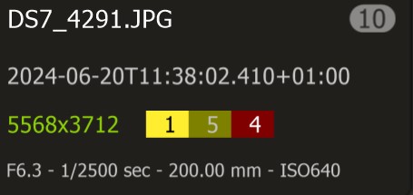

Do you mean like these parameters?
Screenshot 2024-06-28 171646.jpg (206.22 KiB) Viewed 5145 times

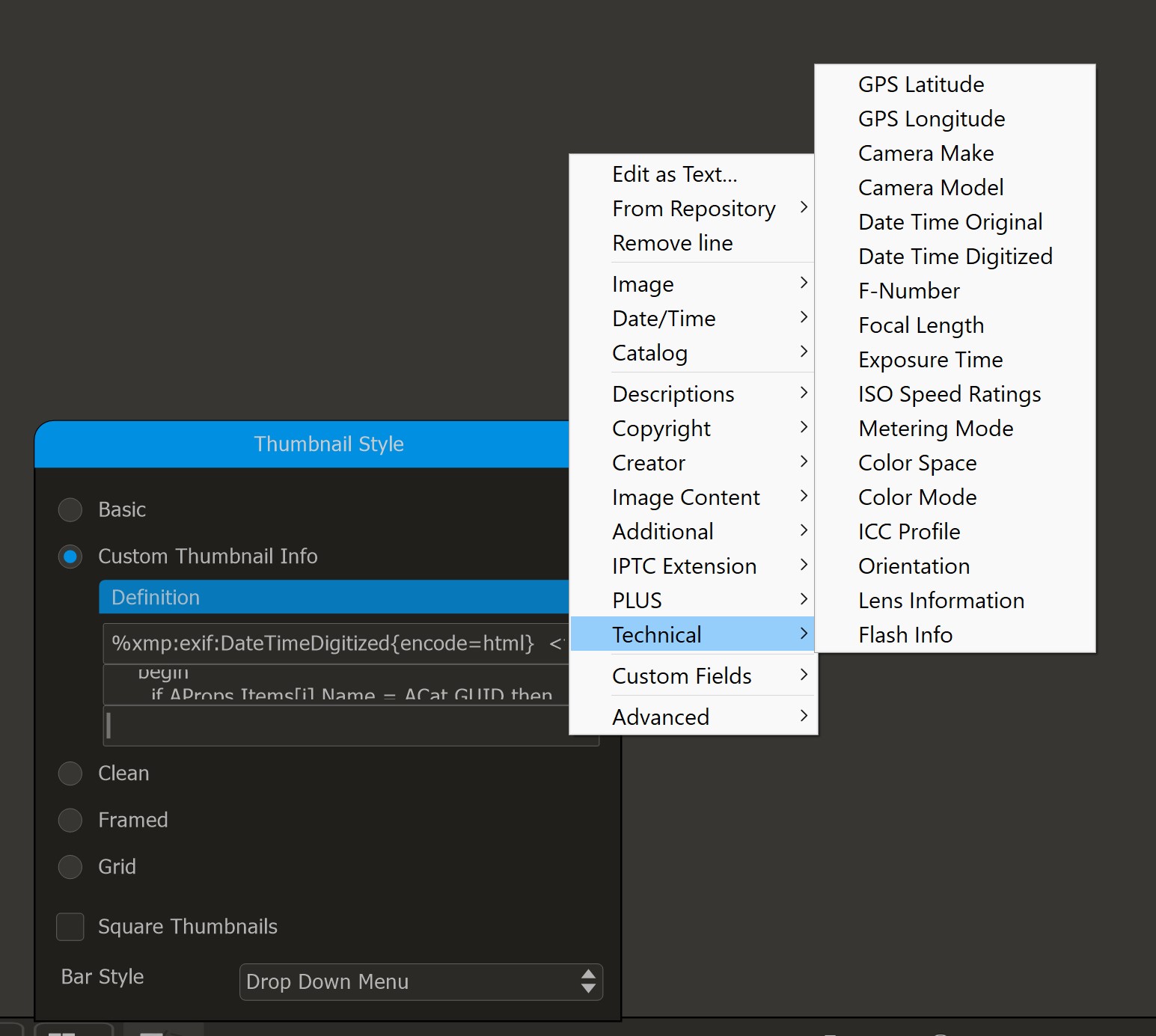

Yes. I looked there but couldn't find anything that tells me Camera Mode. Unless I didn't dig deep enough?

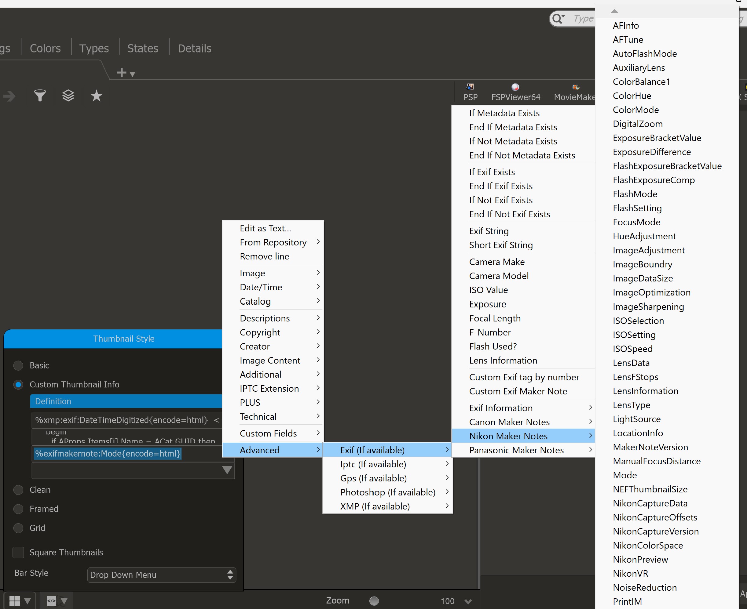

Under individual exif maker notes there is Mode value shown - Try the Short Exif String maybe ? Try below as a custom line
<font size="13">%ShortImageEXIF{encode=html}</font>
Screenshot 2024-06-28 193231.jpg (527.62 KiB) Viewed 5127 times

I found that adding a new field going to Advanced->XMP (If available)->EXIF - Specific Properties Schema the "Mode Program" shows as an option. Odd though while it worked by adding again it's the same field name as my old field that didn't work.
