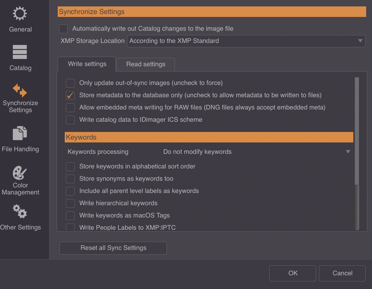

The Synchronize Settings - Write settings is set to Store metadata to the database only.
All other checkboxes are unchecked.
Screenshot 2023-08-24 at 13.58.05.png (533.67 KiB) Viewed 12504 times

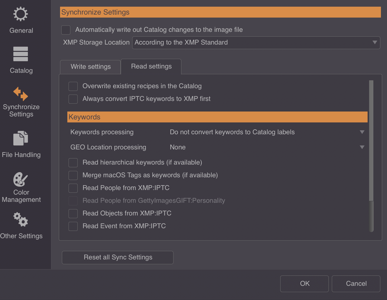

The Synchronize Settings - Read settings - Keyword processing is set to Do not convert keywords to Catalog labels.
All checkboxes are unchecked.
Screenshot 2023-08-24 at 14.00.42.png (501.46 KiB) Viewed 12504 times

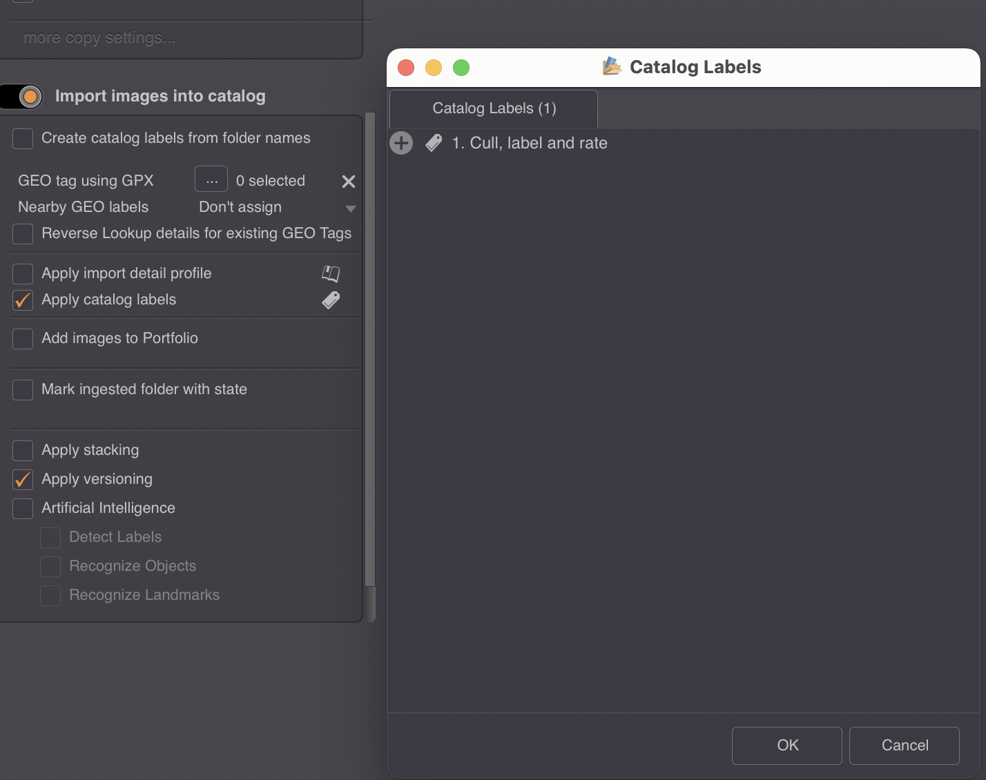

When I import images to the catalog the ingested images are assigned a private Catalog label corresponding to the first step in my workflow.
Screenshot 2023-08-24 at 14.03.15.png (595.18 KiB) Viewed 12504 times

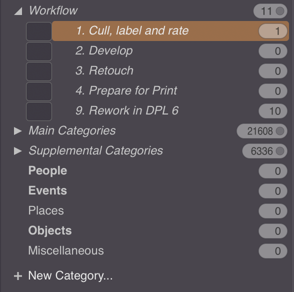

After import of a new image the image has been assigned the proper label and I can find it in the Workflow category of the Categories panel.
