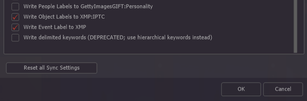

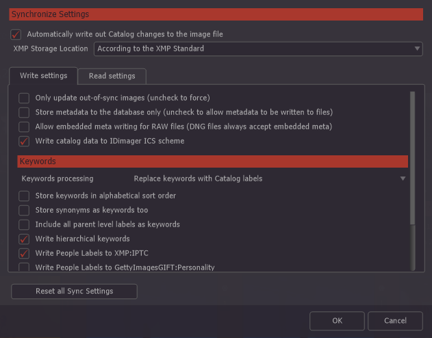

I don't seem to have that option.. see attached images. Not sure what I should be selecting here
- Untitled picture.png (54.86 KiB) Viewed 18932 times
- Untitled picture2.png (19.66 KiB) Viewed 18932 times

Open the drop down list for "XMP Storage location" then select "Always as sidecar file" rather than the standard option.

Thanks, much appreciated
