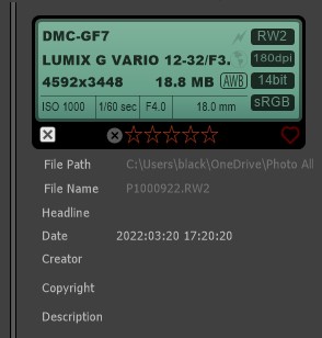

Original RAW
Screenshot 2022-03-20 174407.jpg (18.24 KiB) Viewed 2803 times

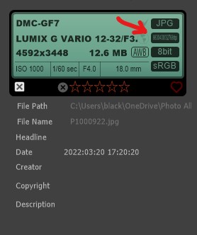

JPG conversion showing funky DPI count.
Screenshot 2022-03-20 174450.jpg (18.13 KiB) Viewed 2803 times

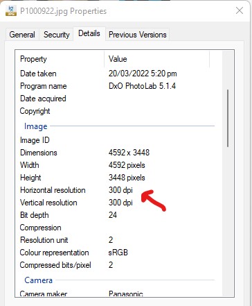

Details tab of Windows file Properties showing correct DPI.
Screenshot 2022-03-20 174541.jpg (37.23 KiB) Viewed 2803 times

DPI is stored at different metadata levels and a tool updating the DPI is responsible to update all of these levels. The info panel shows you what is in XMP's tiff:XResolution field, displayed depending on XMP's tiff:ResolutionUnit field.
You can use right click on thumb -> Run script from repository -> Metadata -> Full Exif Dump
Can you copy/paste the result here (remove personal information if any)?
Tip: from your description it appears that DxO isn't updating the XMP resolution correctly. PSU can fix that for you by using right click -> Metadata -> Convert metadata to XMP. That will re-convert lower metadata levels to XMP, fixing discrepancies at metadata levels. This is especially helpful to fix metadata issues created by tools that update some, but not all, of the metadata levels.
Tip2: Also report this to DxO

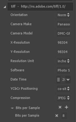

Looking at the XMP tiff:Xresolution field, I can see it has very odd numbers stored. Unfortunately, they are not editable directly, unlike many of the other fields.
Screenshot 2022-03-21 181345.jpg (17.29 KiB) Viewed 2760 times

Thank you for the sample file.
I can now tell you what is in that box. It reads:
9830400/32768dpi
If you do the math then that comes down to 300 pixels per inch. It's untypical for the resolution to be written in such fraction, but that is still a valid way of writing a resolution.
PSU should have done the math here and show it on-screen as 300 instead of the fraction.
