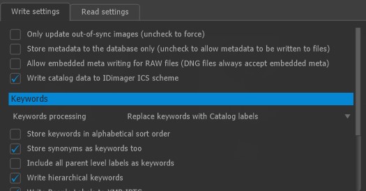

Thank you Hert for giving me the hint with the ICS- Shema. Just to be sure: Is this the right setting (it looks correct to me):
I intend to use two Computers with Standalone PSU and plan to synchronize the database with goodsync on automatic mode (automatic synchronization on file change with delay...) via WLAN . So I would be happy if the catalog is as small as possible and tripple the size means ~tripple the snyc time, which increases failure and conflict possibilities. Therefore I realy want to make sure, if 1,8 GB is the best I can get as I still did not see what was missing before, when the database was <600 MB.
I do understand that my chances a low, but it is worth a try in my eyes.

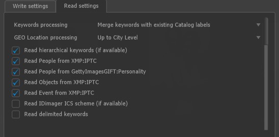

2) I opended it, kept all settings as deault but added "Read IDimagaer ICS sheme (if availabel)
3) I impored the one root folder, in which all my images are in

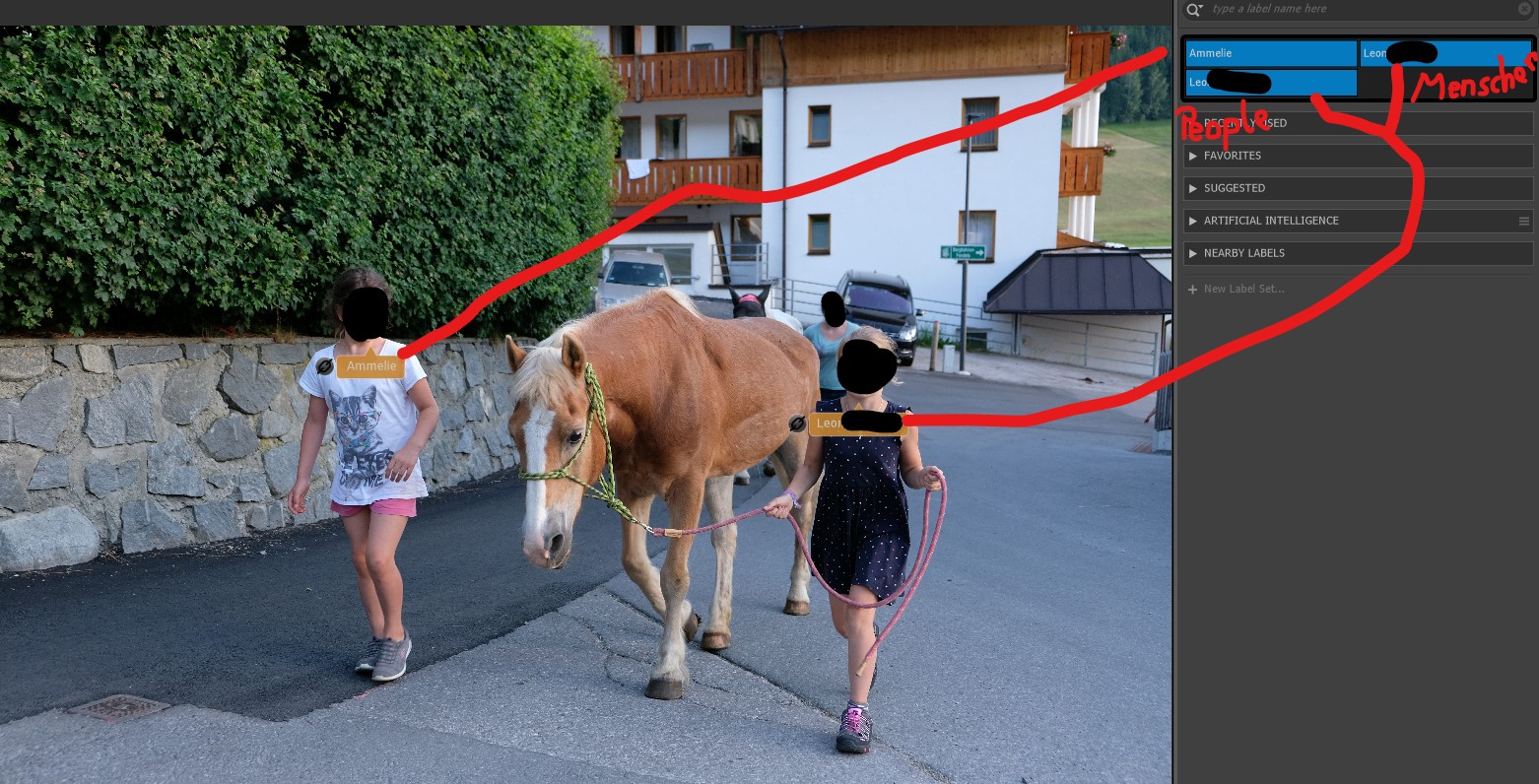

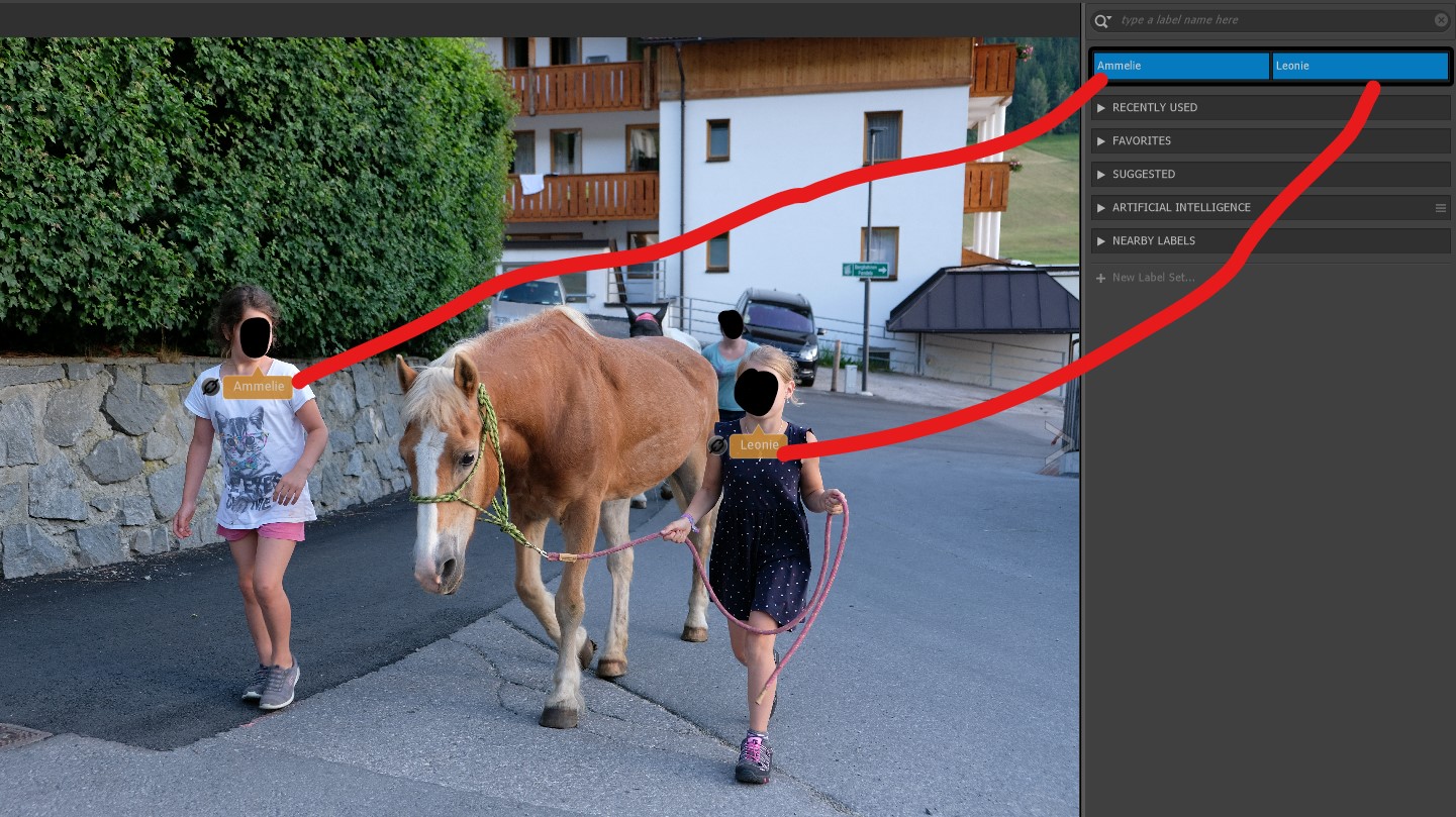

So one issue what I found in the 1,85 GB (after TTP) catalog is, that there are images with Areas and Names linked to the area, where the Label of this area is not in the catalog label list:
Screenshot 2021-04-11 092505.jpg (366.24 KiB) Viewed 5755 times
I believe that happened while working in PSU and is not related to TTP: I will fokus on that a little more below.

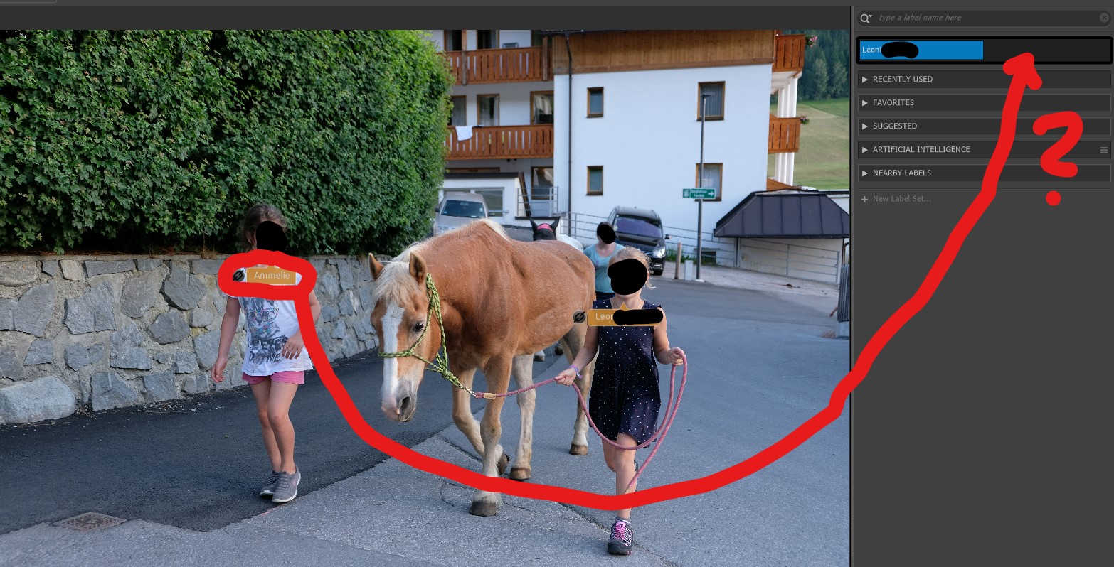

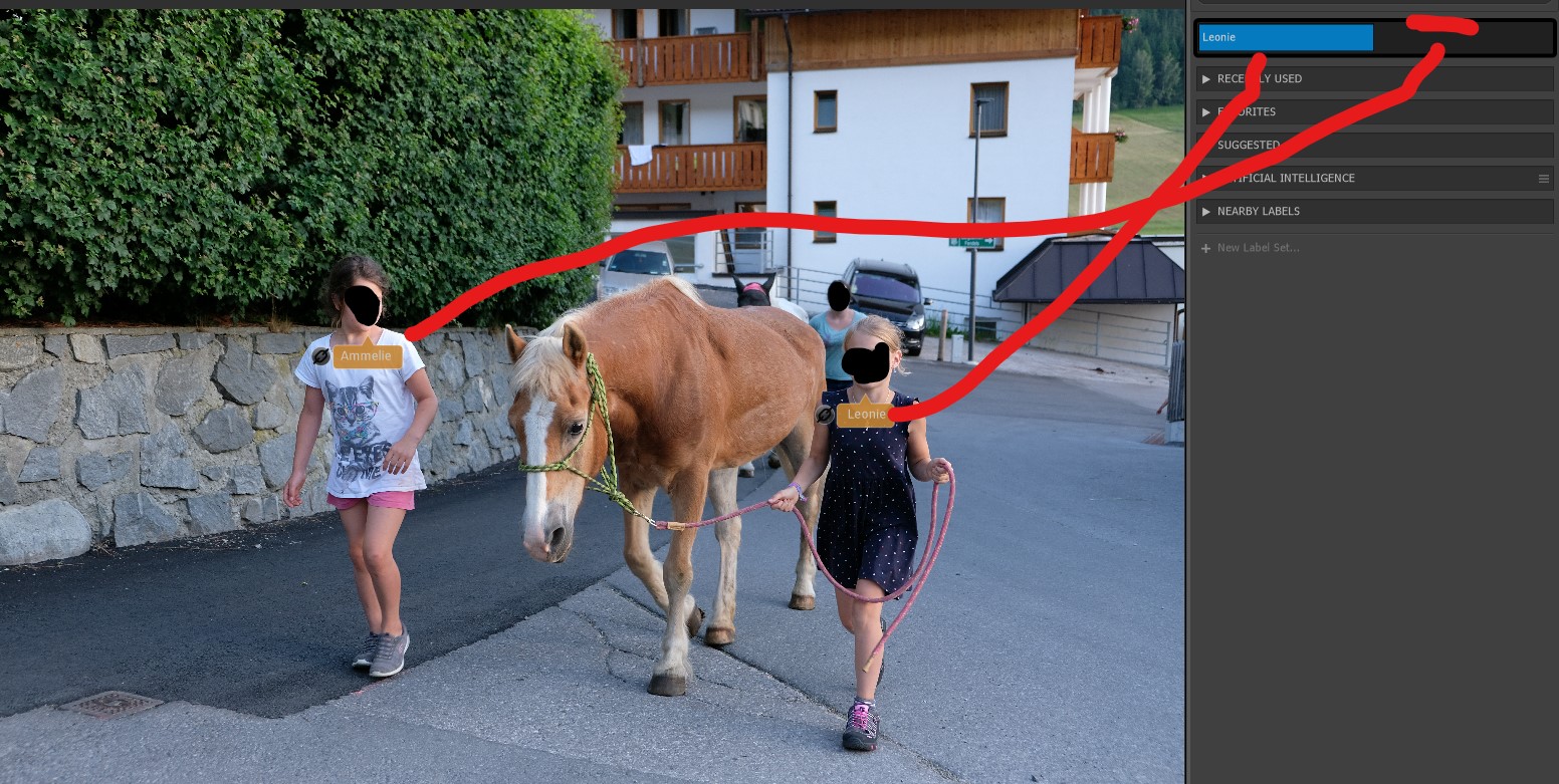

The very same picture and in sync in both catalogs is recognised as following after newly build catalog:
Screenshot 2021-04-11 093421.jpg (379.95 KiB) Viewed 5755 times
So where does this come from in my point of view. (I will have to write this later, as I have family responsibilites now...coming back later.

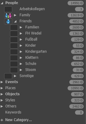

But the result currently is as following:

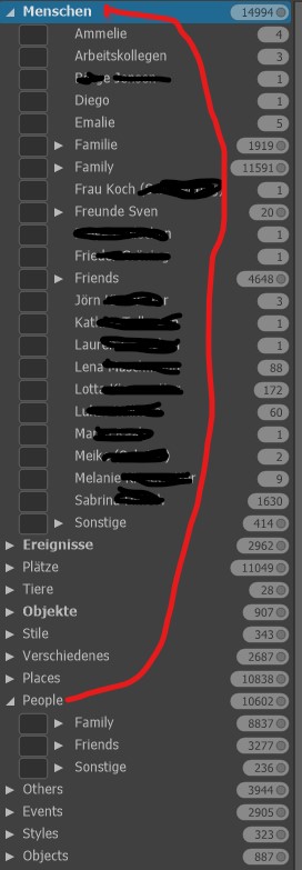

Catalog-Hierarchy of the 1,85 GB Catalog processed with a lot of semi-automtic TTP and manuell PSU work:
Screenshot 2021-04-11 150959.jpg (22.11 KiB) Viewed 5736 times
As already mentioned: No image out-of-sync, no result on "verify folder all" search
So my expectation is, that PSU wrote the latest informations into the files (XMP and ICS).
Catalog Hierarchy of the newly build catalog 1,057 GB Catalog
Screenshot 2021-04-11 151254.jpg (45.88 KiB) Viewed 5736 times
So, what I don't understand:
Why are there still Names like Ammelie in the image meta informations, that PSU V6 finds on import, when there is no out of sync detection before from a catalog where I don't have this name in my catalog anymore.
It would be correct if the name Ammelie would not appear in both, the name "Emmalie" should have been linked to the face of the left girl. And the name Leonie should be labeled only once from PEOPLE and not from MENSCHEN-branch.

So with my limited (but by far not beginner anymore) knowledge I checked and analysed my situation (incl. reading the full EXIF dumb content) and still feel that there is something inconstistant insinde PSU, and I think I can even proof part of it now:
Again, I use one example picture of my catalog that shows two areas with linked labels in the preview, but only one label in the labeling assistent on the right side of the screen.
  • right click -> Metadata -> Read Metadata from File does not change anything, the name Ammelie would not appear blue in the "Selected Labelas" box!
  • (optional step, same result at the end) right click -> Metadata -> Save Metadata to File, now I would expect that a new catalogue would interprete

  • imported only the same one single picture and the result is:
Conclusion: On an import PSU detects "Ammalie" as a label, while "Read Metadata from File" on a picture that is already in the catalog it does not! So importing and Read Metadata does not have the same result

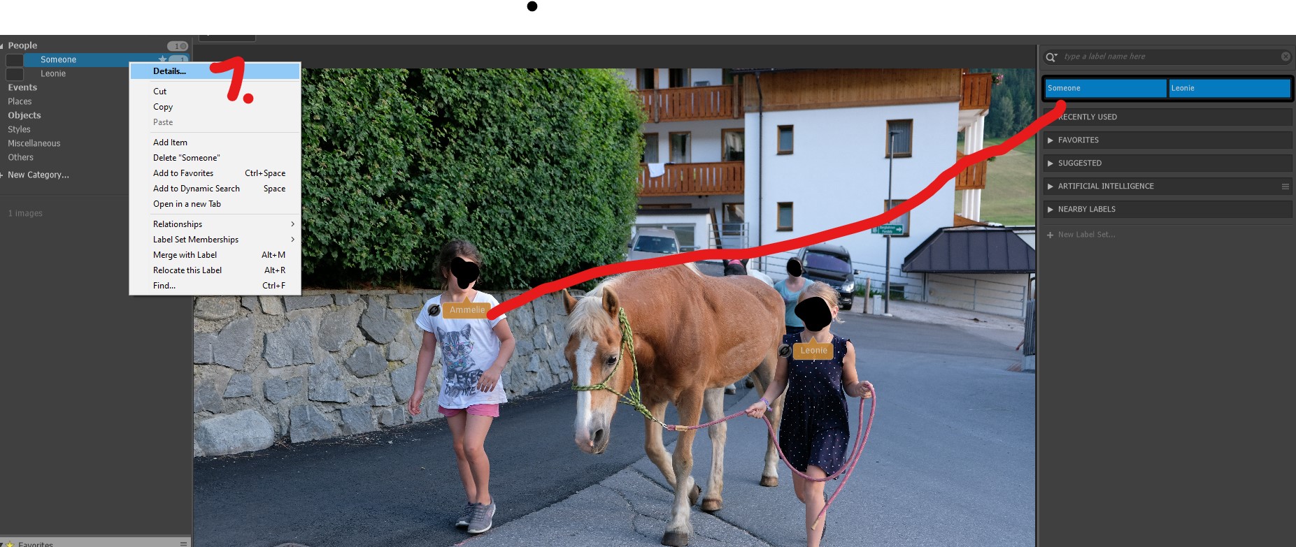

In the Catalog, where I took the second screenshot from and where I only have this one image in, I do following:
  • no matter if activate travel mode or not (I checked both, because I thought it was related to travel mode, but found that it is not)
  • right click the catalog label -> Details... -> Change name
That will change the name of the label, but PSU would not recognise that this label was linked to an area (which it realy should in my point of view) and will not have a label for this area-name anymore but it keeps this area-name.
Unfortunatly I beleive I have messed around strongly with this now! So I have for sure thousands of pictures with an area hierarchical label, that is not in the same place of the hierarchie anymore or even has a changed name. And this is one of the the reasons, why there is not at all constistancy between my "groomed" catalog and the catalog that would build up from a complete import of all my images.

You state that you created a new database. Preferences are stored in the catalog and your new catalog therefore has the default preferences.
You probably have tweaked your Sync setting causing the difference.
Best to reset your sync settings to the default. There's a button for that.
