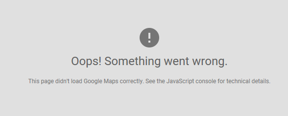

Hi all
After upgrading to V5 and setting up an API Key the AI functionalities, including Objects and Landmark identification, work fine.
However, since I did the API Key thing, the PSu feature “Display on Map” (available when right-clicking a thumbnail) returns an error message. It’s like it - in the very first second - starts loading the map, and then this message pops up:
“Oops Something went wrong! This page didn’t load Google Maps correctly. See the JavaScript Console for technical details”.
I am not familiar with Java and am not sure about the message “…See the JavaScript Console for technical details”.
Are there anyone who knows how to defeat this problem?
Re: Display on Map - Error Message
Working OK here on V5, sounds more like a browser problem ?
I would expect a Google API configuration issue. Did you add a payment method to you Google Account?

Hi Hert.
Thansk for your reply.
I did add a payment method - but will re-confirm this when I am back at my PC tonight.
Post by Mikki »
Problem is solved:
Google recommend adding "API restrictions", and I learned, that it means that each API need to be enabled - which I've now done, and now Display ON Map works. (Getting to know Googles Cloud services here) :-)
Thanks!
Post by paulrbarnard »
Mikki I had the same issue after upgrade. I needed to go into Google API and reselect the required API. I didn't enable restrictions just unchecked and rechecked the Maps APIs.
