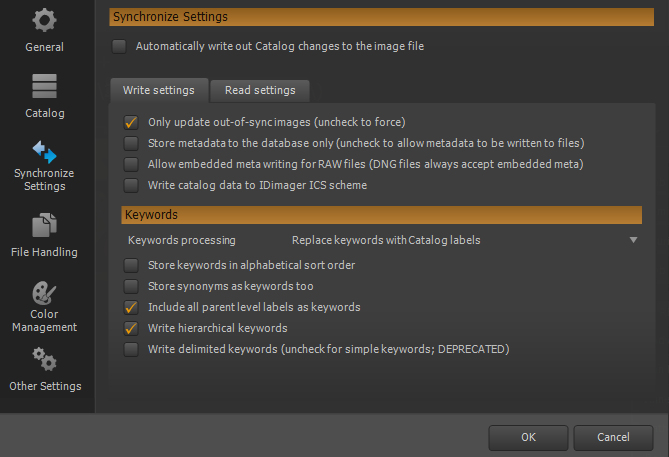

Here are a few settings I have that may be important:
WRITE SETTINGS:
Keyword processing: Replace keywords with catalog labels
Include all parent labels as keywords
Write hierarchical keywords
Write delimited keywords - Delimiter "/"

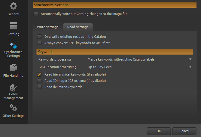

READ SETTINGS
Keyword processing: Merge keywords with existing catalog labels
Read hierarchical keywords
Read delimited keywords - Delimiter "/"

Although the 3 added labels showing in Photo Supreme do not actually show in the file itself (since i haven't saved the metadata after reading it from the file.)
Are there other settings in Photo Supreme that could cause this to happen?
I've attached screenshots of my read/write settings to see if anything looks amiss to you.

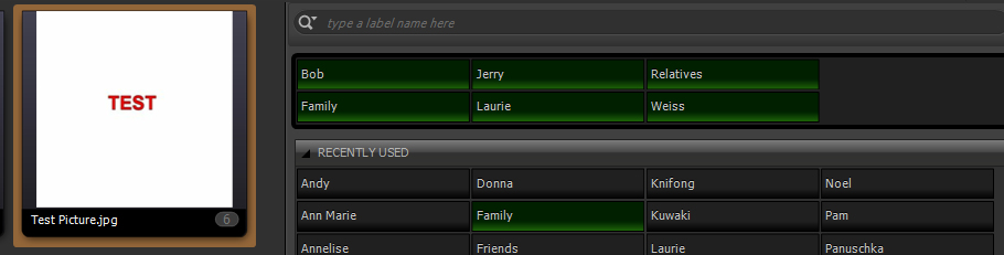

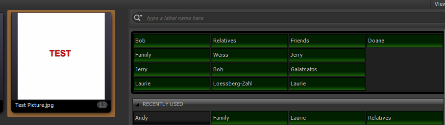

Finally, I added 2 screenshots which show the Photo Supreme labels.
"write Labels.jpg" shows the Photo Supreme Labels immediately after sending the metadata to the file (this is how I want it to look.)
"Read Labels.jpg" shows the photo Supreme Labels immediately after reading the metadata back from the same file.

- Saved Metadata Screenshot.jpg (106.05 KiB) Viewed 4951 times
- Read Metadata.jpg (118.89 KiB) Viewed 4951 times
- Write Settings.jpg (192.89 KiB) Viewed 4951 times
- Read Settings.jpg (151.38 KiB) Viewed 4951 times

However, as I mentioned in my post, the problem occurs when I now select the picture in Photo Supreme (with the hierarchical keywords in the file as shown above,) and then choose "Metadata/Read Metadata from File." I expected nothing would change in the Photo Supreme catalog since I had just saved the metadata to the file a second earlier. Reading it back to the file should show the same exact hierarchical keywords that I just sent to the file. But instead Photo Supreme now shows the following new keywords in the database in addition to the ones listed n the file....
People/Friends/Loesberg-Zahl/Bob
People/Relatives/Doane/Laurie
People/Friends/Galatsatos/Jerry
The best way to understand my problem is to look at the two screenshots above (named "Saved Metadata Screenshot.jpg" and "read metadata.jpg." The first picture (Saved Metadata Screenshot.jpg) is what Photo Supreme shows at the moment I saved the metadata to the file. The next picture (Read Metadata.jpg) was taken moments later when i read the metadata back from the file. Do you notice all those extra labels that appeared? As you can see from the actual photo, those keywords that were added aren't even in the file, so I'm not sure why Photo Supreme is listing the labels. It must have something to do with the last part of the keywords being the same.

I am not any kind of expert with Photo Supreme, so maybe I'm doing something wrong and this is my fault and not a bug in the program. That's why I wanted to video my steps from the very beginning of the install to where it gets messed up, so that you can see if I'm doing something wrong, or if it's an actual bug in the program. The reason I find it hard to believe it's a bug in the program is because there must be tons of people that have databases with people that have duplicate first names or keywords with the last part the same, so I would have thought they would have noticed this years ago with version 3. In any case, I really appreciate you looking into this. If it is my fault, I am truly sorry for wasting your time. If it is a bug, you might want to let people know as soon as possible because it could easily mess up thousands and thousands of labeled pictures.
It should be noted that on my regular computer I have 85,000 pictures and many of my labels have the last part of the hierarchical keyword the same as another, especially with people that share the same first name. So this is happening to thousands of my pictures. The reading of the wrong keyword doesn't affect the actual file unless I send the data to the file after an incorrect read, which unfortunately happened to about 3,000 pictures. But it's nothing I can't fix. On a side note: I absolutely love your program. Your program has made my life sooooo much easier. I love working with photos now!!! So.... THANK YOU!!!
The video is 472MB. I am sorry for the size. I used the worst resolution on the camera, but it still was a large file, and I don't know how to reduce it. The link to the file is the following:
https://www.dropbox.com/s/8vpry2f70vvfa ... 4.mp4?dl=0
Bob
Re: HELP!! Catalog Labels added that aren't supposed to be there
Bob, thank you so much for this video. I had to follow the video to the letter in order to reproduce it. Build 1951 was uploaded to the website to squash this one.
