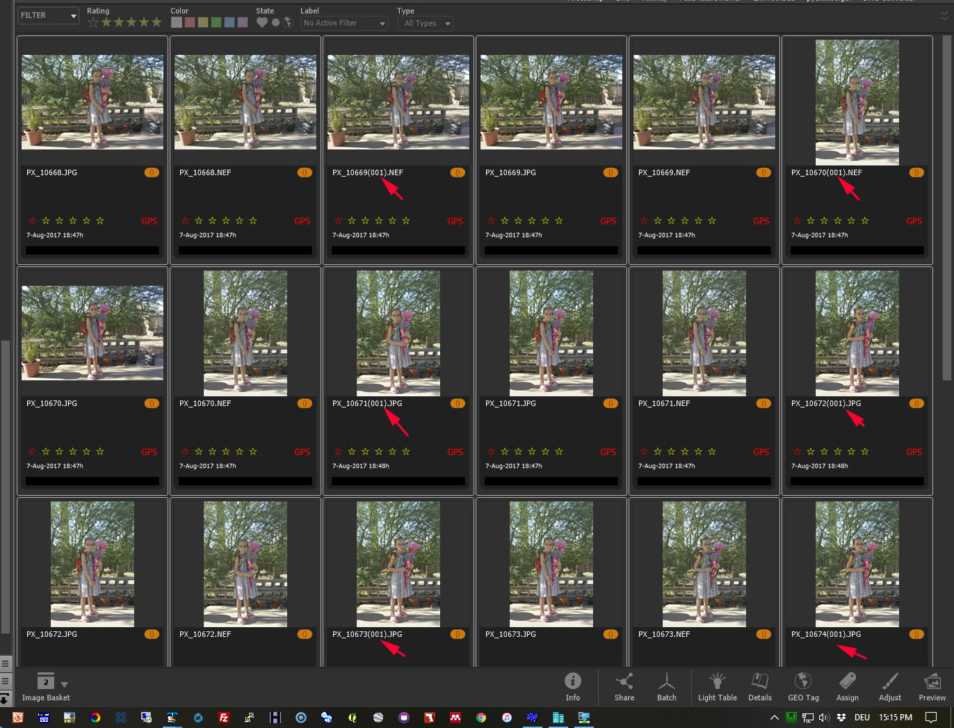

I have just changed one of the old profiles to "Make names unique" and the result is this:
(1) All files are downloaded, none are skipped - good
(2) Ever so often some file names receive an additional (001) appended to their name and thus the JPG+NEF pairing gets messed up and uncessary file names are generated (see screenshot):
If so then your rename script isn’t thread safe. And then we can go forward and change your file naming script so that it can handle multiple threads running concurrently.
I guess that confirms it: the file isn't "thread safe".
It worked before, so probably this has to do with speed improvements through more multi-threading in the new PSU version?
Thanks again for looking into getting this back to work!
