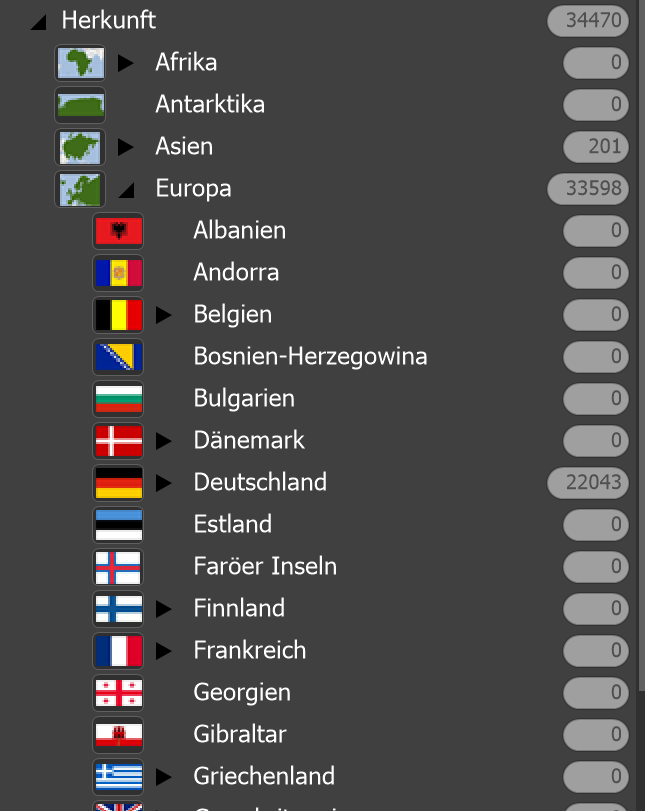

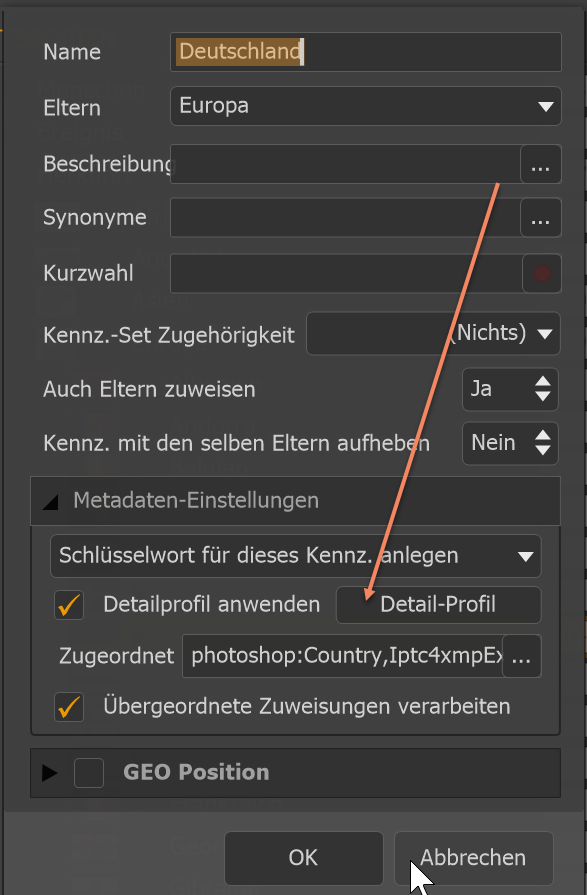

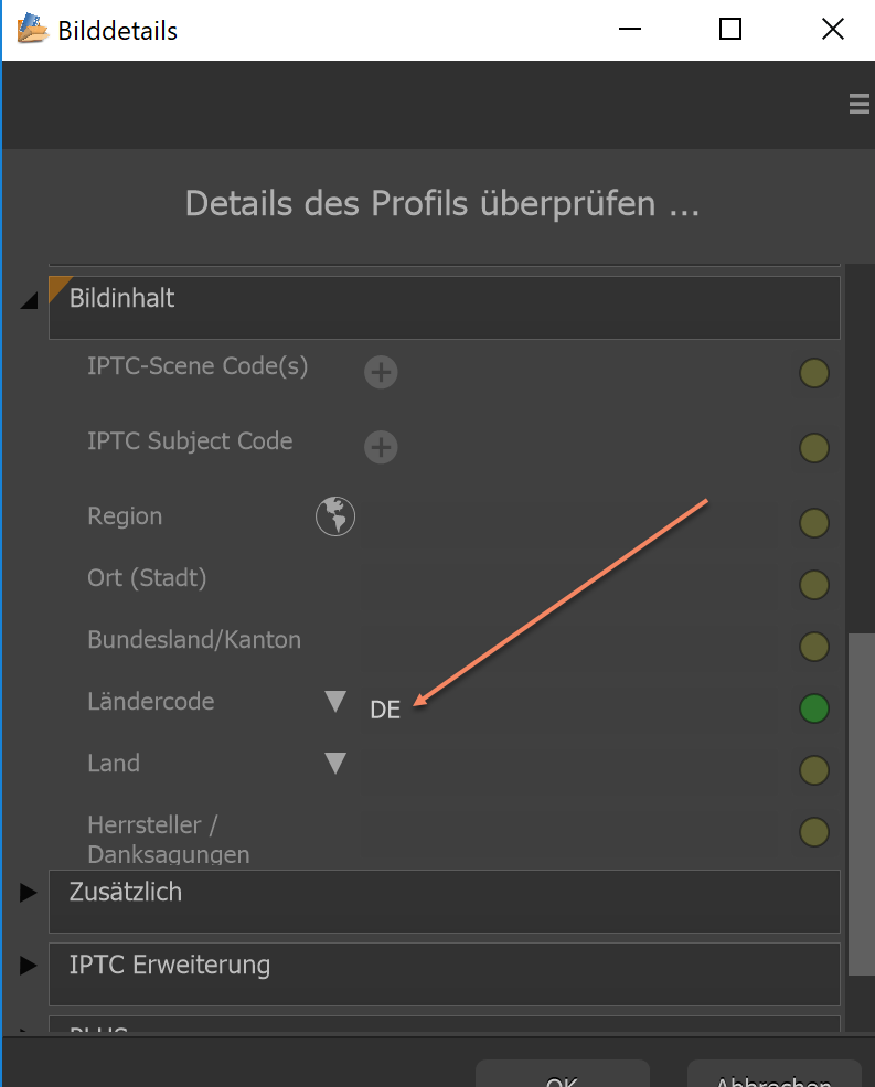

Re: GPS Country Codes
PSU comes with some countries in Places category.
For me, I have extended it to the countries that I have visited or want to visit.
Then I set the settings for each country as in the screenshots (here a example for Gemany)
Robert
