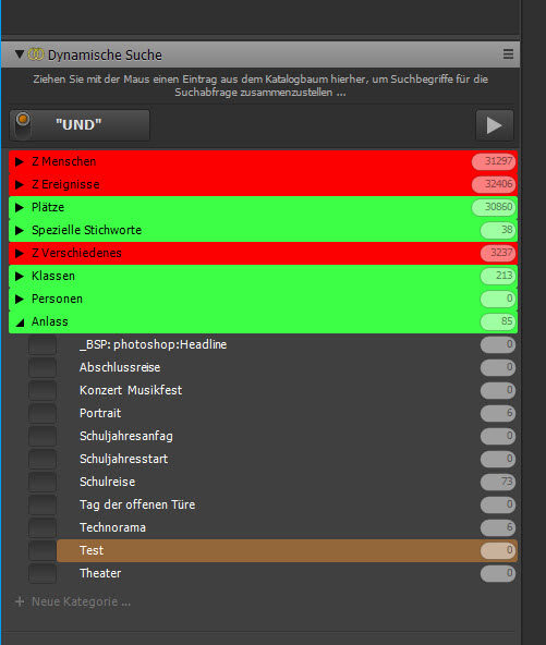

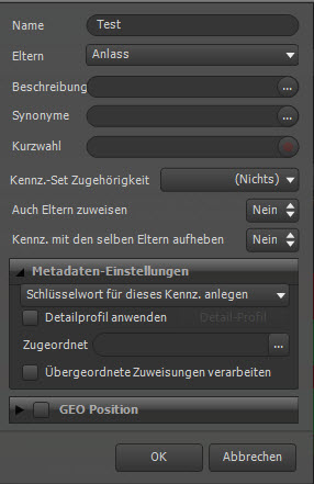

Ok. On the left Side I create a Flag "Test" as you see in Pic01

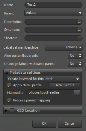

When I'm creating a Flag or Keyword like "Test2" as shown in Pic05
The Flag or Keyword will be placed in the Field Headline AND Keywords.
My wrong thought were, that when I do not set a Metafield as shown in Pic05 nothing will be writen to the file of the Photo. That's wrong.
Result in Pic02
So I can assign the Flag Test to Photos and the Keyword will be placed in the field KeywordsLabels assign to field "State"

From your screen shots I will assume that when you say "Flag" what you mean in Photo Supreme terms is "label". A label can represent a keyword but it does not necessarily have to. I'm not a German speaker but with the help of Google I think I identified your issue. In the label details, under the Metadaten-Eisnstellungen section, it appears that you have left the default setting to create a keyword for this label (Schlusselwort fur dieses Kennz, anlegen). (Sorry for not know how to use the correct characters for German spelling) If you expand that drop down you can select the setting NOT to create a keyword.
Depending on your other settings, data may still be written to your files but a keyword "Test" will not be written.

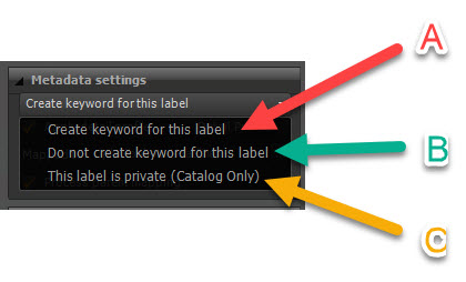

So I can creat a whole tree of labels, to geht some structure.
But I can declare, that a Label is private, so it remains just in the catalog and will not be writen in the file (C)
Or I can declare, that a label is not a keyword and it is used just for building up a structur of labes. (B)
And if necessairy I can create a keyword. (A)
If necessary, I can declare additionaly even a XMP-Field.

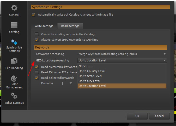

Anyway - I think, one reason, why you are possible struggling with this is because locality labels (= labels in the category "Places") are quite unusual. They can be configured in a way that PSu "second guesses" the intention of someone adding these labels. Why am I saying this. Have a look at "Preferences - Sync Settings - Read Settings". Under "Geo processing" you have several options to configure your labels to be process how to "behave" when you assign a label that corresponds to a specific location. "None" nothing happens, "up to location level" means that when you a sign a label in the Places category, PSu automatically fills in all the metadata fields for you. That works relatively well, but it occasionally messes things up and it fills in erroneous entries into the locality metadata fields.
You can later correct this manually, but you best experiment a bit to understand the different options: One note of caution: IF you enable the "Geo Processing" option and in addition also configure your Places labels to write metadata into fields, then there can occasionally be a conflict between the two processes. In my experience the configuration of your labels takes precedence over Geo processing, but some of the confusion you are experiencing may be related to this...
