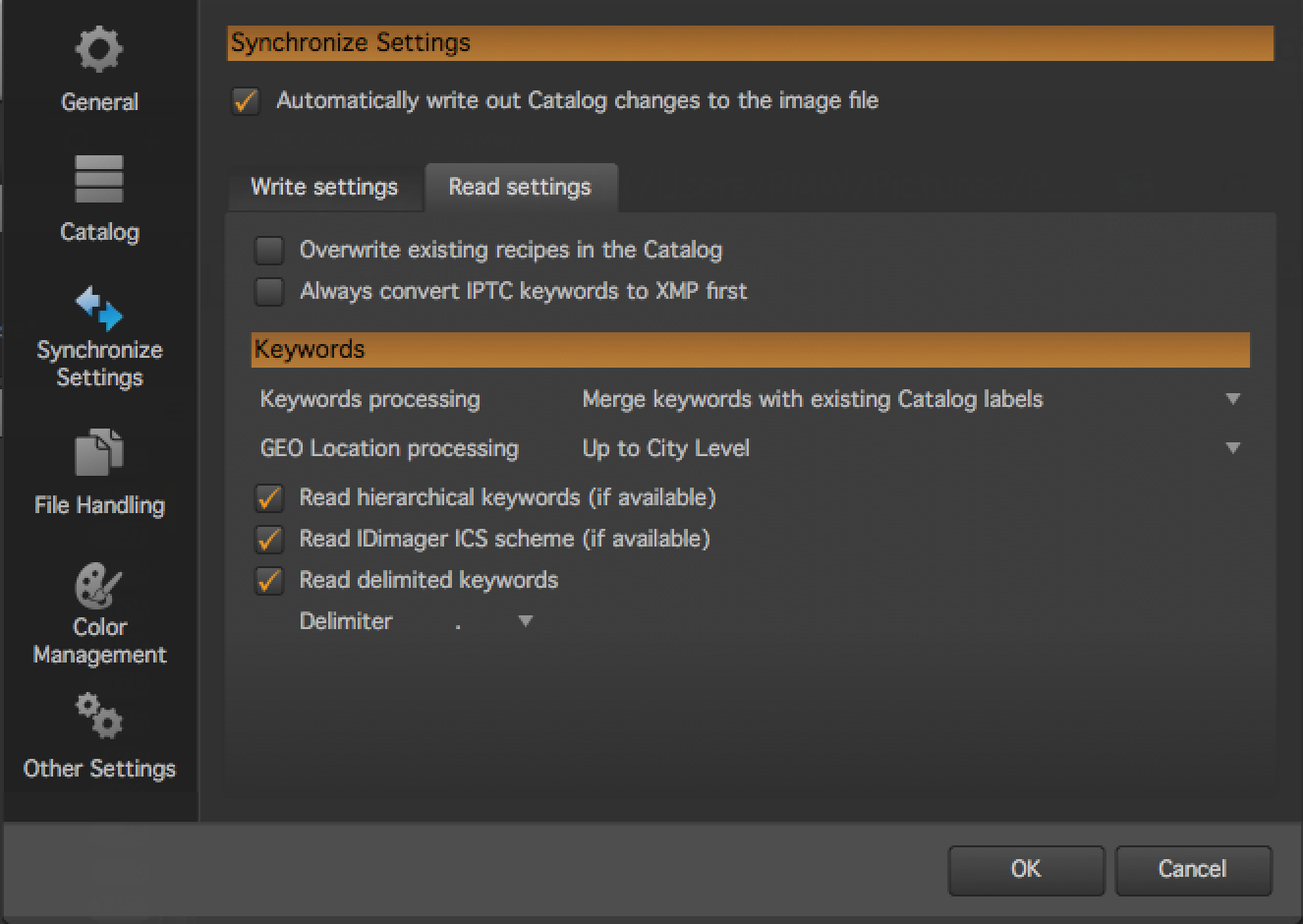

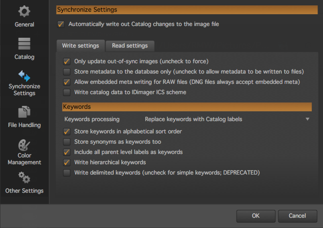

[attachment=0]Write Settings 2016-04-21 at 12.05.51 PM.png[/attachment][attachment=1]Read Settings 2016-04-21 at 12.06.04 PM.png[/attachment]Yet another method is that synonyms of catalog labels can be written to the image file if the pertinent Preferences setting is enabled. If you then write the keywords into the catalog, those synonyms will be added to the tree of catalog labels and automatically assigned to the images. Off the top of my head, this is the most likely culprit of the cause of your problems, especially if a particular combination of Read and Write settings is enabled. (Again, same as in IDimager.)
Yes I think that may be the issue. I had keyword many images prior to starting to use PS and may have made errors at that point (e.g. not "cleared" all selected images before moving on to keywording other images.
I have attached the screen shots of the Read and Write Preference settings. Let me know if that confirms your thoughts.

Your settings clearly indicate that the issue doesn't have anything to do with synonyms unless you had enabled that setting when you used IDimager and had never synched the image files with the catalog until using Supreme. That's because the setting that writes them to the image files is not enabled. On the other hand, if you had enabled the synonyms settings and had never synched the images, you're correct that that might the source of your problem now that you are using Auto Synching.
I think your issue is also probably related to the Read setting that reads delimited keywords. If you had delimited keywords embedded in the image files, they would have automatically been added to your catalog when the files were synched. (You have auto synching enabled.) Those newly added catalog labels would have also been automatically assigned to those images.
Considering that your settings are configured to read and write hierarchical keywords, there is no benefit I know of to reading (or writing) delimited keywords. So, I recommend disabling the setting that reads them. I think that will make your problem disappear but keep an eye on it and get back to us if needed.
To change the subject: I strongly recommend that you disable reading the IDimager ICS scheme and enable writing it. Writing it makes it possible to recreate your catalog if everything that could go wrong does go wrong. Reading it is necessary only when you do need to recreate your catalog. Reading it any other time only slows down the speed of the program.
To ensure that the ICS scheme is written to all files in a reasonable manner once you enable that setting, I recommend that you first temporarily disabling the auto synching. Then select all images one large batch at a time (not all at once considering that you have 19,000 images) and manually sync them by using Ctrl+S. Once you have completed that manual process, it's fine to enable the auto synching again.
One minor point: Considering that you are writing hierarchical keywords, I don't see any benefit to also writing parent level labels as keywords. Doing so results in all the parent level keywords being written to two fields. Doing so is not a problem except that doing so might slow down the program. More important, doing so also doesn't add any value. So I recommend that you disable that setting before following my instructions about implementing the change having to do with the ICS scheme explained above.
Hopefully others can shed light on your situation by adding helpful comments if for no other reason than to confirm that I'm on the right track toward solving your problem.

When I read my previous post, it occurred to me that there are so many issues that make it so complex that it becomes a bit difficult to comprehend. So, to keep things simple, I recommend the following steps to solve the problem you brought to light in your thread and to make other improvements you hadn't noticed need improving.
1. Temporarily disable auto synching.
2. Disable Reading the ICS Scheme until the time (that hopefully never happens) that you need to recreate your catalog.
3. Permanently enable Writing the ICS Scheme.
4. Permanently disable Reading delimited keywords.
5. Permanently disable Writing parent level labels.
6. Select about one-fourth of your images and manually synch using Ctrl+S.
7. Repeat Step 6 until all images are in synch with your catalog.
8. As a measure of safety: In Catalog mode, select By Catalog State. Then display and select all images (if any) that are still out of synch. Manually synch them again using Ctrl+S.
9. Enable auto synching (because you had temporarily disabled it in Step 1).
