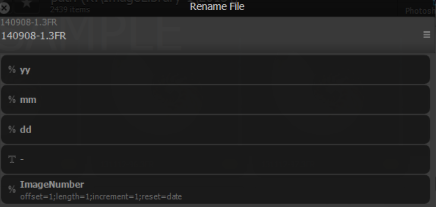

I am attaching a screen shot
- Untitled.png (54.06 KiB) Viewed 9719 times
Re: Sequence numbers in renamed files
geraldmarsden,
You currently have the "length" of your ImageNumber set to 1. You show some files with three digit numbers. Assuming you don't have any four digit numbers you need to set your length value to at least 3. To do that, you would simply click on the Image Number area of the Rename File panel and a smaller panel will open in which you can change the length to 3. In that panel is refers to the length at "Length Padding". You will need to rename all of your files as a batch if you want them to have the correct sequence so make sure you sort them the way you want them to be sorted before doing that. In other words, if you want the sequence numbers to be in the date order, make sure to sort your collection in date order first and then select the entire collection and then do a batch rename. If you leave them sorted by their current file names, the sequence numbers will end up reflecting the way that they are currently sorted.
I hope that helps.
ADDED: You mentioned that you use Lightroom also. I don't but I imagine that renaming these files in Photo Supreme may confuse Lightroom. I'm not sure what you will have to do to account for that in Lightroom but I thought I should mention it. The point of the sequence numbers is really only to insure that you have unique file names. You don't have to use them to sort your images. I prefer to be able to have my images sort correctly by file name so I understand why you would want that but if you don't need that you can simply sort by something other than file name. Let us know if you are not certain how to do that.
I hope that helps.
