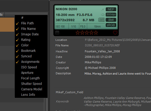

Re: How do I detect duplicates?
Hi There
I am feeling a little slow this morning
I ran the script and came up with about 2200 files in my database.
Now I want to see the filesize of the "offending" pictures - and I can't, for the life of me, remember where to see an image's file size. I tried the Image Details, Technical - Nothing, I tried the Info Button but there are no "file properties" displayed there, I tried grid view - no joy either. I know that I can do a thumbs script but surely I should not have to resort to that to see basic file props ?
Also how do I sort by file size ? There is no column in grid view that I could see.
MikeP
MikeP
Mike,
The file size is displayed in the Info Panel.
Hope that helps
[update; double checked and the file size is not in the Grid by default]
Hope that helps
Hi Hert
Thanks for the fast response.
Yes - There is an "approximate and rounded" file size in the Info Panel - I guess I was looking for more details / exact - maybe in image details.
Also I cannot see the column to tick in the Grid View. Thanks
MikeP
MikeP
Mike,
And indeed it is rounded. For now, to see the file size in detail, you can add %ImageFileSize as a custom field
I think that I updated my post around the same time. It's not in the Grid indeed.mphillips wrote:Also I cannot see the column to tick in the Grid View.

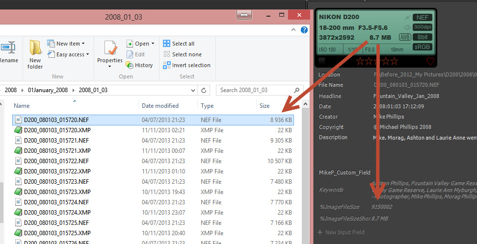

Hi Hert
Just a follow up.
I added some Custom Fields to the info panel and got a strange result on file size versus file size short versus windows explorer .
Please see attached:
Should these all not be approx the same ?
MikeP
Just a follow up.
MikeP
Mike,
A file size of 9150002 bytes
equals
9150002/1024 = 8936 KB
equals
9150002/(1024*1024) = 8,7 MB
equals
equals
