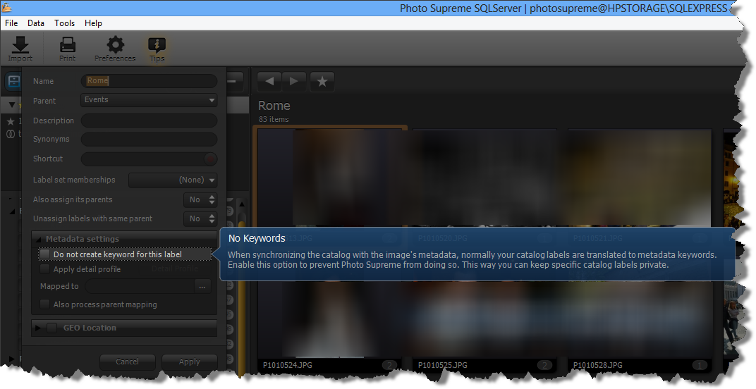

I have been trying to refine the way in which I apply labels, metadata, and specifically keywords to my image files. One area that has always puzzled me is how to handle places (as in names of towns, cities, etc.). I should start by saying that I don't assign GPS coordinates and don't know if I want to go down that road at this point in time. Also, I am an amateur and am not looking for advice on keywording from a "stock photo" perspective.
I have my labels configured to populate the appropriate location fields in my file's metadata space and I love PSU's method of cascading metadata assignments from parent labels when I assign a child label. It is extremely efficient and not easily accomplished with any of the other DAM products I've experimented with. What puzzles me is whether or not I should write location names to keywords as well. It seems redundant to do so but there are also times when it seems appropriate to do so. For and example, I have pictures of the colorful seaport on the island of Curacao at night. To describe those pictures, it seems natural to call it Curacao. It is a recognizable image that somebody might search for using that name.
On the other hand, I have pictures of my wife sitting in a restaurant in Curacao and I there is nothing specific about that scene that would indicate it was in Curacao. I have assigned my Curacao label to both sets of images. If I use the same label, I'm either going to have "Curacao" as a keyword in all of those files or none of those files. The only way I can think to do it selectively would be to have two distinctly different labels for Curacao.
Until now, I have opted to write the locations to keywords. One reason I've done this is because I figured that most programs that I might use to view my photos would look at the keywords but might not look at location metadata fields when I enter a city name in their search or filter fields. This could be a flawed assumption because I've never tested it.
Perhaps somebody with more experience cataloging image files can share with me their strategy and opinions.

I agree with what you've said but I think you failed to grasp exactly what I was asking. You are using "label" and "keyword" interchangeably. In PSU, I can assign a label without writing it to the file as a keyword. I would definitely assign the label Curacao to all of the pictures I took in Curacao because that label is mapped to the appropriate IPTC Country fields. But, PSU offers the option "Do not create keyword for this label" in the label configuration. I assume that by "create keyword" PSU means that it would put the label in the metadata field in which "keywords" are normally stored. (I think it's the dc:subject tag)
This nuance between labels and keywords seems to be the cause of confusion in many of the discussions here about cataloging files. I am guilty of using the terms interchangeably in the past. As I understand it, labels only exist in the catalog (and the PSU specific xmp space if you have PSU configured to write the label structure to xmp). Keywords only exist in the file's metadata (or the sidecar file). The ability to use labels independently of keywords offers some interesting options but I'm struggling with how I want to do that. In the example I've used, there are times when I would want the label to be written to the file as a keyword (I think) and times when I wouldn't. I'm wondering if it would make sense to create two Curacao labels. Perhaps have one under a "Location" branch and one under a "Places" branch in my label hierarchy. That way, I could configure the one in the Places branch to create a keyword and the opposite for the one in the Location branch. I'm just not sure if this added level of complexity is worth it. I'm curious if anyone else has an opinion on this.
Also, the other thing I am curious about is whether or not other photo viewers would find my pictures of Curacao if I didn't create the "keyword" but did include Curacao as the country in which the image was captured. I guess I need to do a little testing to determine that. If so, then I see no real reason for including names of locations in my list of keywords, unless, as I stated in my example, the name of the location actually describes the image.

I wasn't aware that not creating keywords made the label "private". If the label is being mapped to other metadata fields I would hardly consider it to be private. I'm not on a computer with PSU installed right now so I can't test anything but I would like to get clarification about this issue. What are the exact ramifications of selecting the option to "Not create keywords". Does that label still get written to ICS? Would the label be included in the Lightroom keyword hierarchy if that option is selected? In other words, if I have a label structure such as Butterfly | Monarch and I set Butterfly to not create keyword but I leave Monarch configured to create keyword, would my Lightroom keywords not include "Butterfly"? Or, if I set Monarch to NOT create keyword but left Butterfly configured to create keyword, would anything be written to my Lightroom keywords?
Tom Stoddard

tstoddard wrote:I wasn't aware that not creating keywords made the label "private". If the label is being mapped to other metadata fields I would hardly consider it to be private.
I don't remember seeing a documented definition of a private catalog label. For all practical purposes, I agree that a private catalog label is truly private only if it is not stored as a keyword or elsewhere in the physical image file or sidecar file.

Isn't there a "private" attribute for label categories? How does that interact with the setting to not create keywords at the individual label level? (Or am I remembering wrongly ... I'm away from home this week, and have my work PC rather than my home PC with me. So, no access to PSu at the moment.)

Posts: 7947
Re: Keywording Strategies
It's a screen widget so the Tips system should explain the field.
Non-Keyword catalog labels *are* written to the ICS metadata (if ICS writing is switched on)

So by looking at the ICS metadata in a file, can a third party can tell that the (private) label exists in the catalog?
And can they tell that it has been applied to this image?
Posts: 7947
David Grundy wrote:the (private) label exists in the catalog?
That is correct. The term "private label" is not correct and is also not how this field is named.

Yes, sorry for confusing terminology. I'm remembering the term "private" from the Label Category attribute which (I think) is still defined at the Category level only.
Three separate questions then.
(1) Assuming I'm remembering correctly that the "private" attribute exists for Label Categories, does it prevent labels in that category from being written to the ICS metadata?
(2) Assuming that I have a label that isn't in a private label category ... When I assign a label to an image, and that label has the attribute "don't write keywords to the metadata", can a third party tell that the label is assigned to that image?
(I now assume the answer is "yes".)
(3) Forgetting about labels which have these specific attributes set, and jsut looking at the usual situation where keywords get written out and the ICS metadata writing is turned on ... What I always imagined would happen is the the ICS metada in the file contains exactly the branches needed to define the position of all assigned labels in the label tree structure, and no further information. Is that a correct guess?
... David

David Grundy wrote:(1) Assuming I'm remembering correctly that the "private" attribute exists for Label Categories, does it prevent labels in that category from being written to the ICS metadata?
Yes, correct, catalog labels in "private categories" are not written to the metadata.
The answer is indeed "yes", that is...if you have ICS writeing switched ON, which is recommended.
ICS contains: catalog label structure, area definitions, version relationships (including placeholder(s)), and portfolio collection structure

IDimager wrote:Non-Keyword catalog labels *are* written to the ICS metadata (if ICS writing is switched on)
Thanks for that clarification, Hert. From what you've stated, I believe it is important for people to understand that if they truly want their labels to remain private, then they also need to switch off the writing to ICS in their synchronization settings or at least write xmp to side car files only. I'm not at my home computer and I don't recall if that is an option in PSU.
Since the synchronization settings are global then switching off the writing to ICS would be a trade-off that the user would need to be willing to make. I am willing to sacrifice the privacy of my label structure for the ability to be able to rebuild my catalog using that ICS metadata.
I would expect other programs to look at my keywords when I use their search functionality to find images but I wouldn't expect them to look in my ICS metadata. However, they may do that anyway. Any program that wants to search all metadata is free to do so.

IDimager wrote:The term "private label" is not correct and is also not how this field is named.
Ahem. The catalog labels being discussed seem to be implemented in Supreme exactly as in IDimager, where the documentation explicitly describes them as being private catalog labels. For those of us who grew up on a farm and notice something walking by that looks like a duck, walks like a duck and quacks like a duck, we always call it a duck even when we see it on a city sidewalk. Similarly, for those of us who "grew up" on IDimager and see a particular kind of catalog label behaving exactly the same in Supreme as in IDimager, it's understandable why we would call it the same. :mrgreen:
Having said that, I'll try to remember to not call these catalog labels private in the context of using Supreme.
